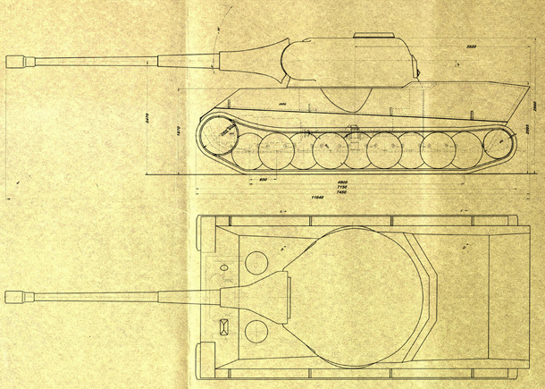

technical drawing of the VK 70.01, also known as the Löwe, by Krupp; source: internet, public domain, edited
Development of the new tank was entrusted to Krupp in December 1941. In historical context, this was a logical choice. Krupp had not participated in the concurrent design competitions for the medium tank Panther or the heavy tank Tiger (for the latter it had only submitted a turret design), so compared to its rivals it had considerable spare capacity, and its design office was able to begin work on the new contract immediately. The project was designated VK 70.01, reflecting the expected weight of 70 tonnes. However, the specification given to Krupp apparently set the maximum permissible weight at as much as 90 tonnes — most likely dictated by the load capacity of railway flatcars.

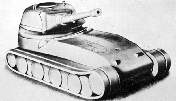

a reduced-scale model of the Löwe in the May 1942 configuration, which envisaged two Porsche diesel engines with a combined output of 840 horsepower and a rear-mounted turret; source: internet, public domain, edited

The signing of this contract did not, however, put an end to the debate over armour thickness. On 9 April 1942, two new drawings appeared showing two distinct variants of the tank. The first retained 100 mm of frontal armour and 80 mm on the sides, while the second featured 120 mm of frontal armour and side armour varying between 80 and 100 mm. The expected weight of the first variant was now 76 tonnes; the second came in at 90 tonnes. The top speed naturally differed as well: 26.8 km/h for the lighter version and 23 km/h for the heavier one. For some reason the hull of the heavier variant was to be 40 cm longer than that of the lighter one (7,050 vs. 7,450 mm, not counting the gun overhang). Both variants were to share the same 105 mm gun with a 70-calibre barrel, 800 mm wide tracks, and torsion bar suspension.

In Hitler's view, however, the tank was still not robust or heavy enough, and as early as March 1942 he initiated the development of yet another super-heavy tank — one that would later become known as the Maus. While designer Ferdinand Porsche played the leading role in that project, Krupp was also involved. This collaboration between the two firms appears to have spilled over into the Löwe development as well. Evidence of this is the final proposed Löwe design, submitted on 11 May 1942, which envisaged two Porsche diesel engines with a combined output of 840 horsepower. In this last variant, the Löwe was to weigh 90 tonnes, carry a 150 mm gun, and have its turret mounted not in the centre but at the rear of the hull.
