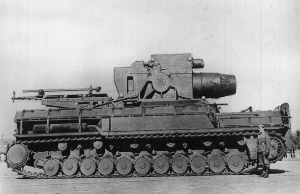

self-propelled gun Gerät 040 (also known as Mörser Karl or Karl Gerät), this is vehicle Nr. I or Nr. II with the original running gear fitted with eight rubber-tyred road wheels, source: flickr.com with the permission of the publishing user, edited

view of the vehicle's bow and the gun's enormous breech chamber; the vehicle is in travelling configuration — the chassis is raised and the crew working platforms are folded, source: wikipedia.org, Public domain, edited

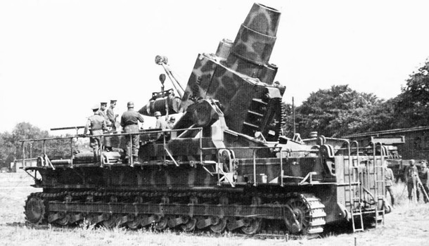

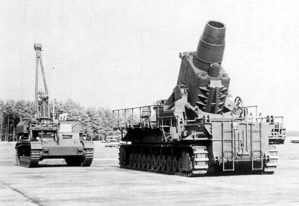

Karl Nr. I (here already renamed from Adam to Baldur) in firing configuration — the chassis is lowered, the crew working platforms are deployed and the ammunition carrier is presenting a shell to the loading ramp, source: flickr.com with the permission of the publishing user, edited

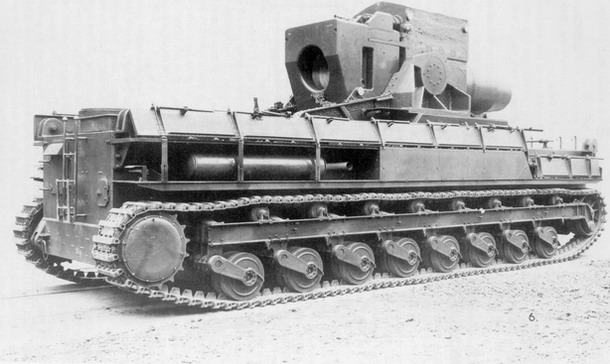

The running gear of the first completed Karl Gerät mortar consisted of eight road wheels on each side. These wheels were fitted with rubber-tyred rims and each was suspended on its own swinging arm. The arms were sprung by torsion bars mounted transversely across the hull tub. The upper run of the track was supported by eight small return rollers. At the front was a toothed drive sprocket and at the rear an idler wheel. On the outer side, the wheel assembly was reinforced by a beam running from the first road wheel all the way to the rear idler. The tracks were 500 mm wide, each consisting of 133 links. The length of the track contact surface with the ground was 700 cm.

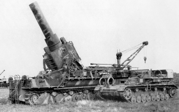

Karl ready to fire; the ammunition carrier based on a Panzer IV tank presents the next two-tonne shell, source: flickr.com with the permission of the publishing user, edited

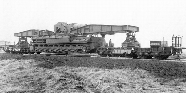

special railway transporters with enormous supporting arms were developed for moving the Karl mortar by rail; the Karl was suspended from these arms, source: wikipedia.org, Public domain, edited

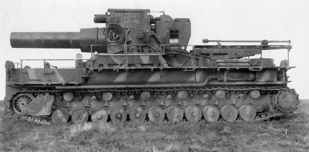

Thor again, this time as Gerät 041 with the 54 cm gun, source: flickr.com with the permission of the publishing user, edited

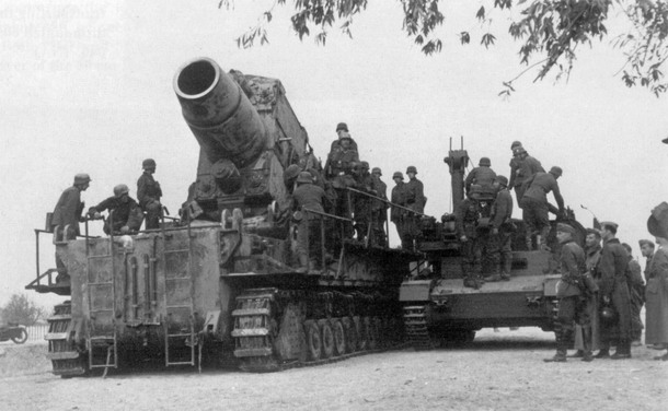

Karl Gerät Nr. III from 2nd Battery of Schwere Artillerie-Abteilung 833, during the bombardment of the Brest-Litovsk fortress in June 1941, source: flickr.com with the permission of the publishing user, edited

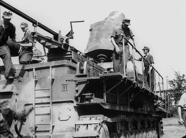

Karl Nr. VI — Ziu — during the bombardment of Warsaw in August or September 1944, source: wikipedia.org, Bundesarchiv Bild 101I-695-0424-30A, Creative Commons, edited

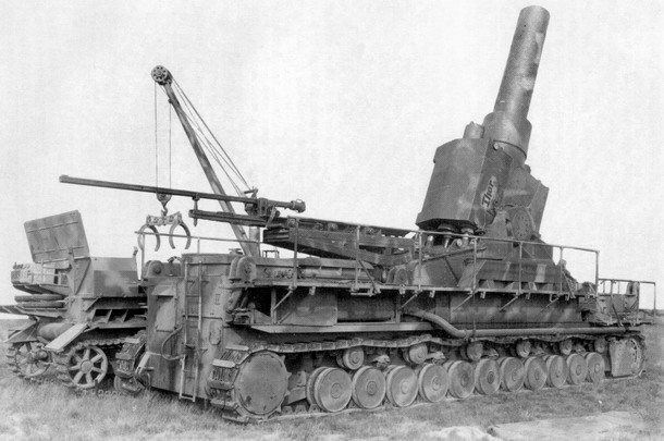

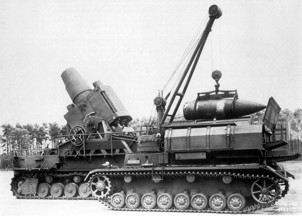

Gerät 040 and its ammunition vehicle, source: wikipedia.org, Public domain, edited

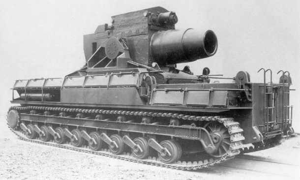

Gerät 041 with the chassis raised in the travelling position; the loading ramp is nonetheless installed, as is the pipe extending the exhaust outlet, source: flickr.com with the permission of the publishing user, edited
