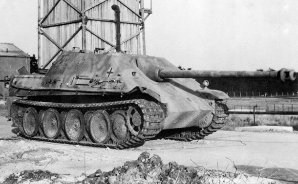

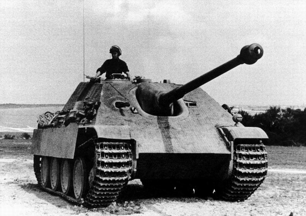

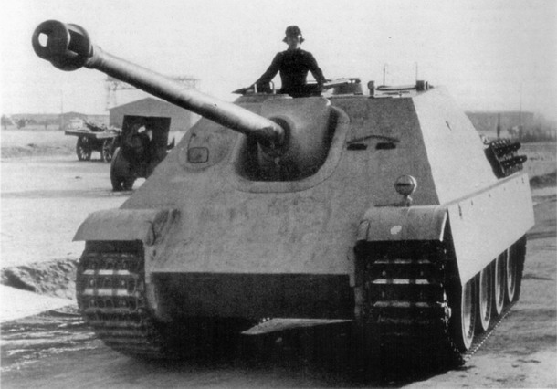

Jagdpanther
the first Jagdpanther prototype was completed in October 1943, source: Flickr.com with the permission of the publishing user, modified
Krupp was therefore to produce drawings and a full-scale wooden mock-up by 10 November 1942. The first sketches were submitted to the arms office on 9 September 1942. Adolf Hitler reviewed them at the end of September and was reportedly satisfied with the design, confirming the continuation of the project. On 15 October, for reasons that remain unclear, it was decided that once Krupp had finished the drawings and mock-up, further development would be handed over to Daimler-Benz. Krupp retained responsibility for the gun and its mounting within the fighting compartment.
The full-scale wooden mock-up was presented to representatives of the arms office in November 1942. A widely debated aspect of the design was the method of installing the gun in the front wall of the fighting compartment. The front plate was angled quite steeply to maximise protection, and the designers had to determine what form the gun mantlet should take in order to integrate as seamlessly as possible with the front wall without creating any vulnerable weak point. The gun aperture also had to be large enough to allow not only the weapon itself to be removed, but also the entire gearbox housed in the front of the hull — which in turn meant that the armoured fighting compartment could be permanently welded to the hull, since it would never need to be lifted for gearbox servicing.
Following their review of the documentation and mock-up, representatives of the arms office indicated they expected production to begin no later than December 1943, with Daimler-Benz as the designated manufacturer. Armour plate was to be supplied by Brandenburger Eisenwerke. In December 1942, however, another change of manufacturer was decided upon. While Daimler-Benz was to complete the vehicle's development, series production would take place at the MIAG plant in Braunschweig.

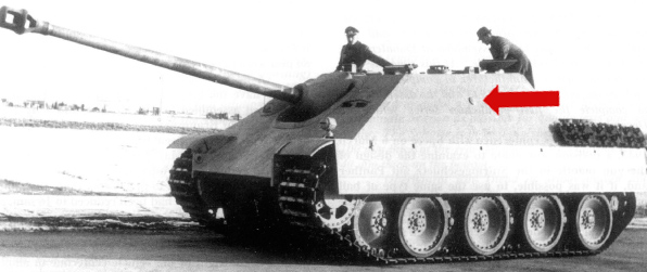

Jagdpanther
the second prototype still retained pistol ports in the rear and side walls of the fighting compartment, source: Worldwarphotos.info with the permission of the site operator, modified

In October 1943, MIAG delivered the first evaluation prototype, designated V101 (V = Versuchsfahrzeug = experimental vehicle). The second prototype, V102, followed in November. Both vehicles were used for trials. They differed from the later early-production machines in only a few details, identifiable in photographs by essentially two features: the absence of the anti-magnetic Zimmerit paste (applied to production vehicles but not to the prototypes), and the pistol ports for crew small arms in both side walls and the rear wall of the fighting compartment. The prototypes had one such port in the left side wall, two in the right side wall, and two more in the rear wall (the plug of a side pistol port is clearly visible, for example, in the photograph HERE (source: Flickr.com)). On production vehicles these ports were eliminated entirely. The first series-production Jagdpanthers began rolling off MIAG's assembly line in January 1944.

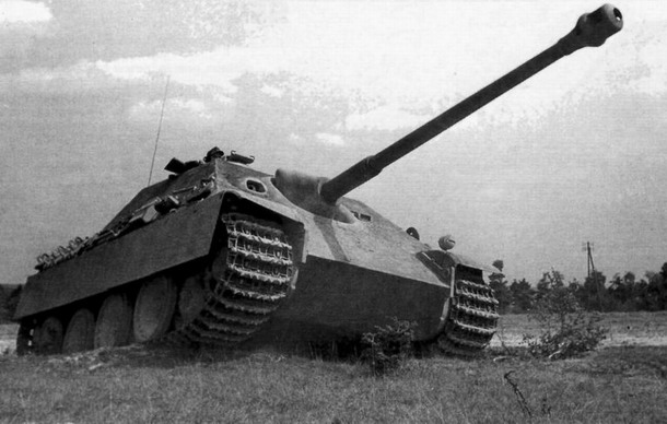

Jagdpanther

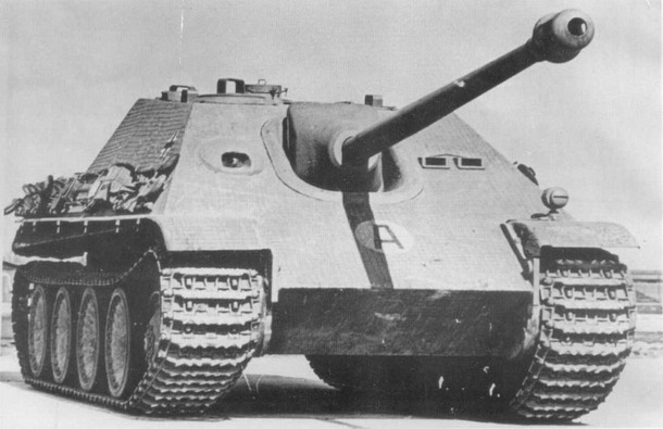

early production Jagdpanthers had two driver's vision ports and a one-piece gun barrel, source: Flickr.com with the permission of the publishing user, modified
Vehicle Description

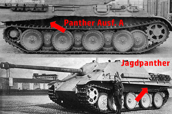

The first series-production Jagdpanthers were based on the chassis of the Panther Ausf. A. The road wheels on each side of the suspension were arranged on eight axles. Each wheel consisted of two discs, and by alternating the disc arrangement on even and odd axles, the wheels partially overlapped one another. At the very front was the toothed drive sprocket, and at the rear the idler wheel. Immediately behind the drive sprocket was a small return roller that helped lift the upper run of the track before it engaged the sprocket teeth. The road wheels were sprung by double torsion bars. Their diameter was 860 mm and, for a smoother ride, they were fitted with solid rubber tyres around their circumference. The tracks were 660 mm wide.
The hull nose was formed by the sharp junction of two frontal plates. The lower plate was 50 mm thick and angled at 55 degrees. The upper plate, 80 mm thick, ran from the nose directly into the front wall of the fighting compartment. In the upper portion of this plate, slightly to the right of centre, was the gun. Into the aperture in the front wall was fitted a cast gun cradle, which formed a recess set back into the fighting compartment. Onto the gun barrel itself was fixed a cast conical mantlet — similar to the well-known Saukopfblende of the StuG III — which filled most of the recess in the front wall. This arrangement allowed the gun the movement necessary for aiming while avoiding any significant weak point in the front plate. To the right of the gun was a hemispherical ball mount for an MG 34 machine gun. To the left of the gun were two rectangular vision ports for the driver.
The side walls of the fighting compartment were continuous with the hull sides and were 50 mm thick. It is worth emphasising that the armoured body of the Jagdpanther was not produced simply by welding a new fighting compartment onto the hull of an existing Panther tank. On the contrary, most of the armour plates were manufactured specifically for the Jagdpanther. This is precisely why the tank destroyer could have straight upper edges to its hull sides above the tracks, while the Panther Ausf. A had stepped ones — as can be seen HERE (source: Flickr.com). Even the lower nose plate differed from the standard tank: while on the Panther Ausf. A it was 60 mm thick, on the Jagdpanther it was reduced to 50 mm to save weight. In practice, the only section of the hull carried over essentially unchanged from the original tank was the engine compartment.

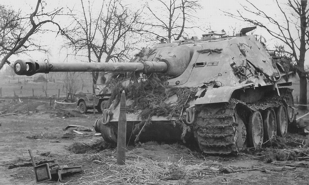

Jagdpanther
this Jagdpanther knocked out on the Western Front has only one driver's vision port. The hole drilled in the armour for the second port has been blanked off with a plate, which is clearly visible here. Also worth noting are the shell casing in front of the vehicle and the small lifting eyes on the gun mantlet and muzzle brake, used to attach foliage for camouflage, source: Worldwarphotos.info with the permission of the site operator, modified

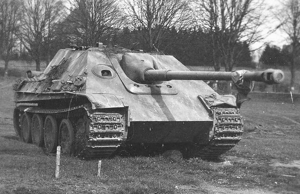

a Jagdpanther captured by the Allies, source: Flickr.com with the permission of the publishing user, modified

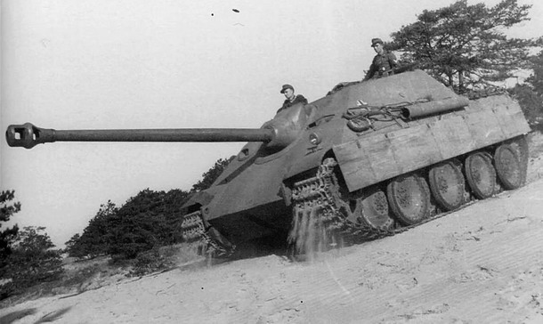

Jagdpanther

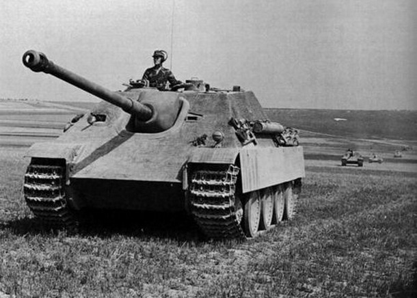

the ideal terrain for the Jagdpanther was open, clear country where it could make full use of its range and accuracy — a pity that it ended up fighting mainly in the West rather than in Russia, source: Flickr.com with the permission of the publishing user, modified

As already noted, the pistol ports for crew small arms were eliminated entirely on production vehicles. Drilling the ports into the side walls was labour-intensive and the openings also reduced the overall integrity of the armour. Rather than side pistol ports, a different weapon was installed in the roof of the fighting compartment to deal with enemy infantry at close quarters — a grenade and smoke launcher known as the Nahverteidigungswaffe (literally "close-defence weapon"). The launcher itself was mounted inside the fighting compartment, beneath the roof, with its barrel opening through the roof plate. As well as anti-personnel fragmentation grenades, it could fire smoke grenades, and the barrel could even be used to discharge signal flares. In practice, deliveries of the Nahverteidigungswaffe were delayed and the first production Jagdpanthers had to be completed without it; the prepared roof aperture was simply covered with an armour plate. The crews of these early vehicles therefore had only the hull machine gun for dealing with enemy infantry.

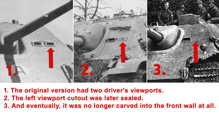

Jagdpanthers produced before June 1944 had two small rectangular vision ports for the driver in the front wall of the fighting compartment. From June 1944 onwards, as a production simplification, only one port was fitted — the right-hand one of the original pair. On newly manufactured front plates the aperture for the left port was no longer cut, though existing stocks of plates with both apertures continued to be used, with the left aperture simply blanked off with a welded armour patch. According to some sources this patch was only 5 mm thick — rather thin, though perhaps it offered much the same level of protection as the block of bulletproof glass that had originally filled the opening, and in any case a direct hit on such a small spot was a remote prospect. A comparison photograph of a Jagdpanther with two ports and one with a single port can be viewed HERE.

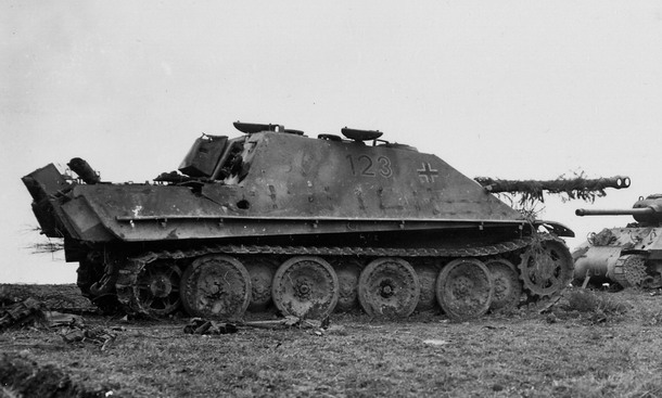

Jagdpanther

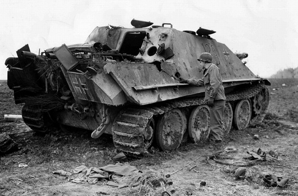

Western Front — two enemy rounds have penetrated the side armour of this Jagdpanther and destroyed the engine; the crew appear to have escaped, source: Wordwarphotos.info with the permission of the site operator, modified

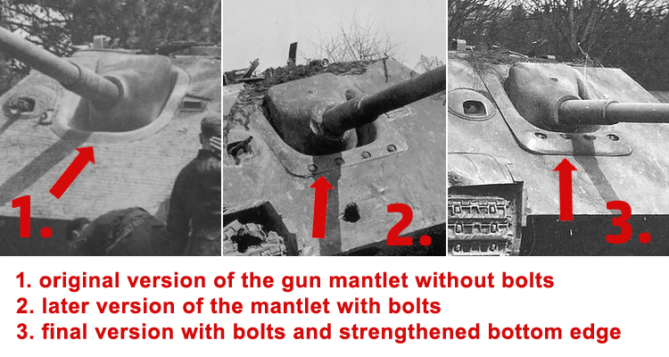

From August 1944, Jagdpanthers received a redesigned gun cradle for mounting the gun in the front wall. The original cradle was bolted to the front plate from inside the fighting compartment. In the new design, the connecting bolts passed through an external flange on the cradle — eight bolts in total, four in the upper and four in the lower part of the flange. In October 1944 the flange was modified again, with its lower edge strengthened and extended downwards to ensure a better fit in the front wall aperture. A comparison of all three flange variants can be seen HERE.

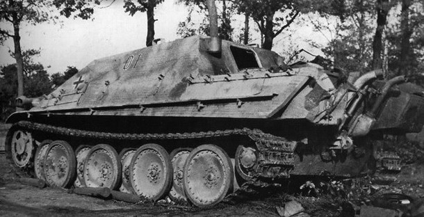

Jagdpanther
a command Jagdpanther knocked out on the Western Front, source: Flickr.com with the permission of the publishing user, modified

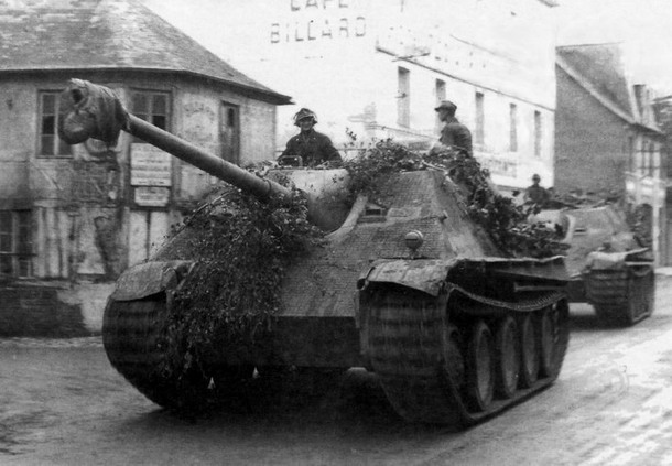

Jagdpanther
Jagdpanthers of sPzJgAbt 654 in France, source: Worldwarphotos.info with the permission of the site operator, modified
Organisation
Jagdpanthers were organised into so-called heavy tank destroyer battalions (schwere Panzerjäger Abteilung, or sPzJgAbt). Each such battalion consisted of three companies (Kompanie), each subdivided into three platoons (Zug), with each platoon equipped with four tank destroyers plus supporting vehicles. Each company also had its own command section with two additional Jagdpanthers. A company at full strength therefore fielded 14 tank destroyers (3 × 4 plus 2). The battalion also had its own headquarters company (Stabkompanie) with a further three vehicles. The full battalion thus had 45 Jagdpanthers: three combat companies of 14 each, plus the battalion headquarters company with 3.

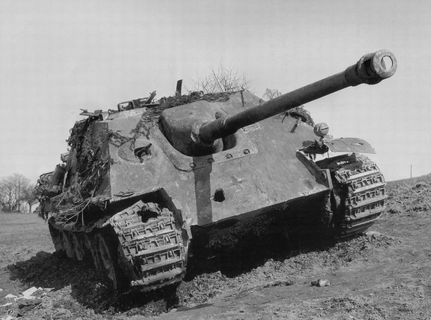

Jagdpanther
again the Western Front — a penetration through the frontal armour demonstrating that the Jagdpanther was not invulnerable even when attacked head-on, source: Flickr.com, Public domain, modified

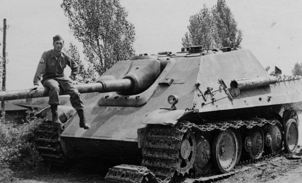

an American soldier poses beside a knocked-out Jagdpanther: Flickr.com, Public domain, modified
