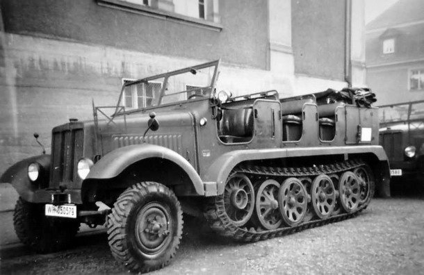

the Sd.Kfz. 6 half-tracked artillery tractor, source: worldwarphotos.info with permission of the operator, edited

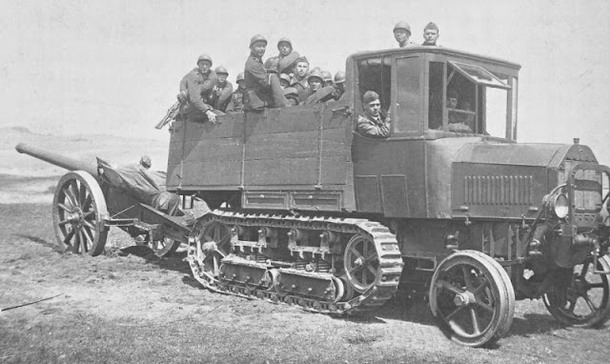

during the First World War the Germans deployed the Marienwagen half-tracked tractor (the one shown here appears to be in service with another army), source: landships.activeboard.com, public domain, edited
The German army, of course, also needed to supply its forces, and it too turned its attention to half-tracked vehicles. From 1915, engineer Hugo Bremer worked with army backing on converting a standard four-tonne Daimler truck into a half-track. Several prototype variants were tested in 1916, and the resulting vehicle was introduced into service as the Marienwagen — named after the Marienfelde district of Berlin where it was manufactured. It was used to transport troops and supplies and to tow artillery pieces.
The rear of the chassis was tracked while the front retained two spoked wheels. The driver's cab and cargo body were carried over from the original truck, giving the vehicle a distinctly civilian appearance. The Marienwagen apparently never saw widespread use and remained a fairly marginal type. In 1917 an armoured variant was even produced, making it in effect Germany's first armoured personnel carrier. In 1918, Benz — at that time still an independent company, separate from Daimler — also built a half-track prototype of their own, again based on a converted standard truck. The vehicle, designated Kraftprotze, was not particularly successful and appears to have been built in only a handful of examples.

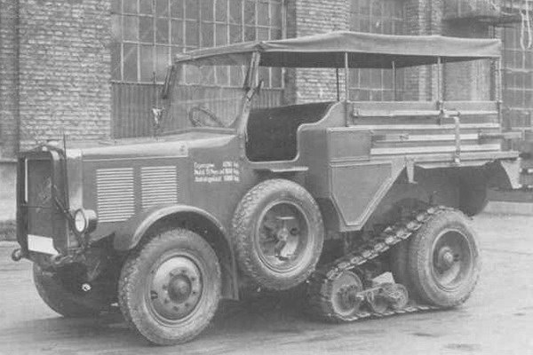

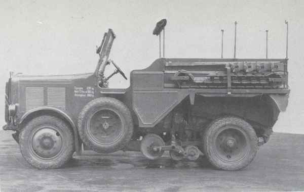

The Treaty of Versailles probably did not explicitly prohibit Germany from developing half-tracked cargo tractors for military purposes. However, given the sweeping reductions imposed on the German army, demand for this type of vehicle was very limited. Development of military half-tracks continued nonetheless, led primarily by the firm Krauss-Maffei. Around the turn of the 1920s and 1930s, it produced several types of half-tracked tractors for the Reichswehr. One example was the smaller MSZ 201, which looked much like a conventional wheeled vehicle but featured road wheels ahead of the rear axle that allowed the fitting of rubber tracks (a photograph without the tracks fitted can be found HERE). The army apparently purchased 24 of these vehicles, and there were even experiments with building an armoured and armed version.

In the early 1930s, the Germans decided to take a more systematic approach to half-track tractor development and launched a programme to develop and build six vehicle types, categorised by towing capacity from 1 to 18 tonnes. Development of the individual vehicles was contracted out to various firms — alongside the already mentioned Krauss-Maffei, these included Büssing NAG, Daimler-Benz, FAMO, Demag, and Hansa-Lloyd. Having learned from the shortcomings of previous types, the German Ordnance Office this time left nothing to chance and drew up the design specifications itself. There was to be no hybrid arrangement allowing travel on wheels alone; instead the emphasis was on maximising the use of the tracks, with the tracked section made as long as possible. The running gear of the tracked section was designed using a very modern arrangement of large, overlapping road wheels — a solution that proved highly effective and was the work of engineer Ernst Kniepkamp.

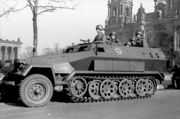

the Sd.Kfz. 251 served as an armoured infantry carrier and as a mount for a wide variety of weapons, source: Bundesarchiv_Bild_101I-801-0664-37, Wikimedia, Creative Commons, edited
The programme produced six types of half-tracked tractors that entered history under the ordnance designations Sd.Kfz. 6, Sd.Kfz. 7, Sd.Kfz. 8, Sd.Kfz. 9, Sd.Kfz. 10, and Sd.Kfz. 11. Since their design had largely been determined by the Ordnance Office's specifications, all six were closely related in appearance. In addition to their primary role of towing loads and recovering other vehicles, all of them also served as the basis for a variety of self-propelled weapons, most commonly anti-aircraft guns.
Beyond these, the German army also operated several other types of half-tracked vehicle. The most famous by far was the armoured infantry carrier Sd.Kfz. 251. Somewhat less celebrated was its smaller cousin, the Sd.Kfz. 250. There was also the ammunition carrier Sd.Kfz. 252 and the artillery observation vehicle Sd.Kfz. 253, both intended for assault artillery units. Over the years a whole range of additional prototypes appeared that never reached production. The Germans also made use of captured half-tracks, particularly those of French manufacture. The most modern half-track type that Germany put into production — not until late 1943 — was the so-called Schwerer Wehrmachtschlepper.

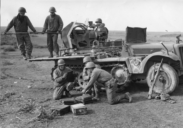

even standard half-tracked artillery tractors were converted into self-propelled weapons — shown here is an Sd.Kfz. 10 fitted with the Flak 38 anti-aircraft gun, source: internet, public domain, edited
Virtually all German half-tracks were originally built as non-combat vehicles intended for hauling cargo or carrying troops. As the war progressed, however, they were increasingly pressed into combat roles and converted to carry all manner of weapons. This was driven less by any coherent doctrine than by the desperate need to offset the enemy's numerical superiority in fighting vehicles. The frantic effort to fit the most powerful weapons possible onto half-track chassis reached its logical extreme in a prototype of the Sd.Kfz. 251 armoured personnel carrier chassis fitted with the 75 mm PaK 42 anti-tank gun with a 70-calibre barrel — the desperation of that particular design, one suspects, is apparent even to the casual observer (photograph HERE).
