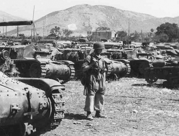

a German paratrooper guards a marshalling yard of captured Italian equipment near the town of Tivoli; at least three Semovente da 75/18 self-propelled guns are visible in the background, source: Flickr.com with the permission of the publishing user, edited

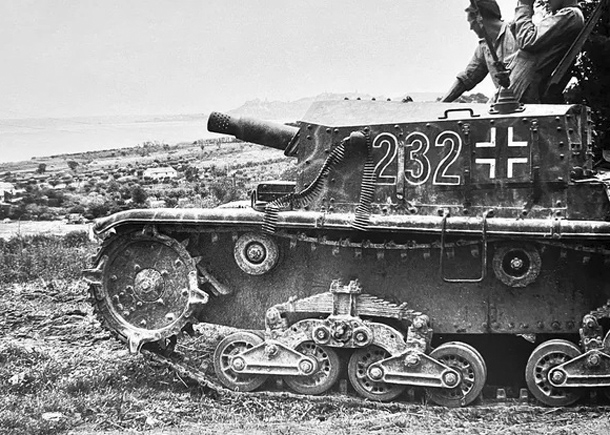

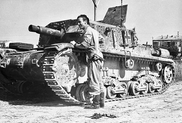

another photograph of vehicle No. 232 from 2nd Company of Panzerjäger Abteilung 278, captured by Polish soldiers; the four large sprocket teeth added to the front drive sprocket by the Germans are clearly visible here, source: Flickr.com with the permission of the publishing user, edited

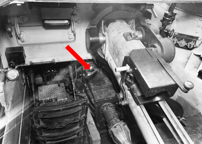

The gun was not mounted on a pedestal — because the gearbox mentioned above occupied that space — but was fixed directly to the front wall of the compartment using 12 heavy bolts. The gunner, who also served as commander, sat to the right of the gun. For aiming the weapon he used a periscopic sight that extended through an opening in the compartment roof. The maximum range of the howitzer was around 9.5 km — applicable to its standard towed version with elevation up to 45°. Once installed in the self-propelled gun with its limited positive elevation, this figure dropped to around 7 to 7.5 km.
The Semovente M40 had no built-in secondary armament. The crew did, however, have the standard light machine gun Breda Modello 1930 of 6.5 mm calibre at their disposal. The machine gun could be used either freely — simply placed on its bipod on the compartment roof — or attached to a special mount on the roof, which allowed aimed fire against approaching enemy aircraft. When not in use, the machine gun was stowed along the right side of the compartment. It must be said that this was not a particularly happy choice of secondary weapon. The Breda Modello 1930 was underpowered, unreliable and fed not by a belt but by 20-round clips. Thirty loaded clips were carried on board — 600 rounds in total.
To the left of the gun was the driver's position, where the driver operated the vehicle using two conventional steering brake levers. Directly in front of him was his main vision port, fitted with a closeable armoured shutter. The port was not filled with any glass — so when open, it was truly open. In combat areas the driver was therefore advised in his own interest to keep the port closed and rely on the periscope that opened onto the compartment roof. Besides the gunner's sight and the driver's periscope, the roof also featured a pair of large entry hatches, in front of which was the already-mentioned machine gun mount, an antenna mount for the radio set on the left, and a rotating periscope for the commander on the right. In the centre of the rear wall of the compartment was a covered air intake for the engine's cooling system, with two small circular closeable firing ports for small arms on either side of it.

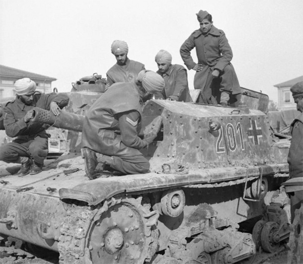

Indian soldiers from the British Army inspect a knocked-out Beute Sturmgeschütz M42 mit 7.5 cm KwK L/18 850(i), source: Worldwarphotos.info, Public Domain, edited

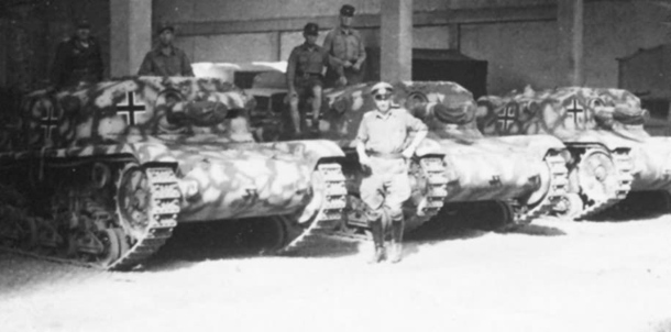

the 7th SS Volunteer Mountain Division "Prinz Eugen" also received Beute Sturmgeschütz vehicles with the 75/18 gun and deployed them in anti-partisan operations in Yugoslavia, source: Flickr.com with the permission of the publishing user, edited

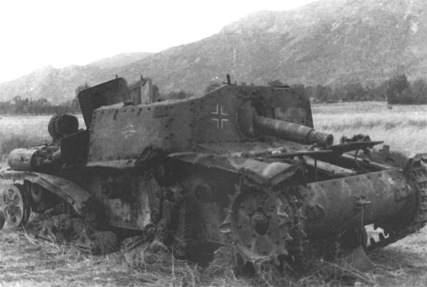

a destroyed Beute Sturmgeschütz M42 mit 7.5 cm KwK L/18 850(i), source: Worldwarphotos.info with the permission of the site operator, edited

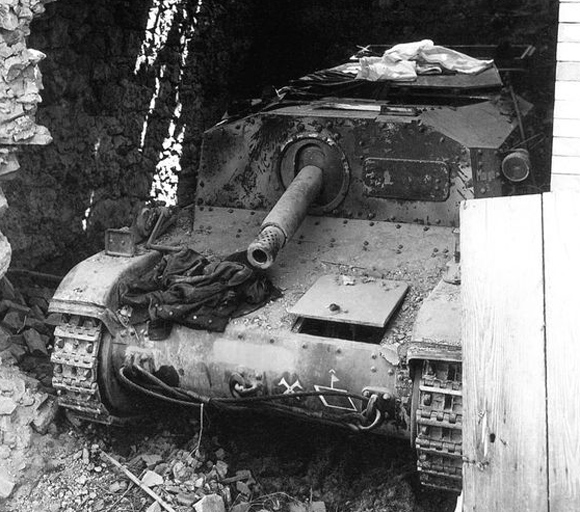

a Beute Sturmgeschütz da 75/18 abandoned by its crew somewhere on the Gustav Line; the badge of the German 71st Infantry Division is clearly visible on the front armour, source: Worldwarphotos.info, Public Domain, edited

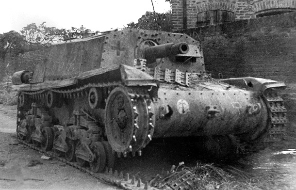

The assault guns produced to the German order received four new large teeth on the front drive sprockets, intended to prevent the tracks from slipping off under heavy load — for example in muddy terrain. The hatch of the right-hand entry hatch was divided into two smaller sections, brackets for hanging steel helmets were added to the sides of the fighting compartment, and there were presumably other minor modifications as well. Somewhat surprisingly, none of the sources mentions the replacement of the radio set with a German type, which was quite standard practice with captured equipment.

a destroyed Beute Sturmgeschütz M42 da 75/18; the vehicle does not have the four large teeth on the drive sprocket, confirming it is one of the vehicles seized directly from the Italian army, source: Worldwarphotos.info, Public Domain, edited
