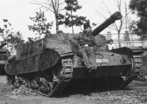

a German soldier sits on the armour of a Semovente M43 da 105/25 — or Sturmgeschütz M43 mit 105/25 853(i); it is interesting that the vehicle still carries its original Italian camouflage and registration number, yet the drive sprocket already has the additional large teeth — suggesting the Germans had these fitted even to some already-completed vehicles, source: Worldwarphotos.info with the permission of the site operator, edited

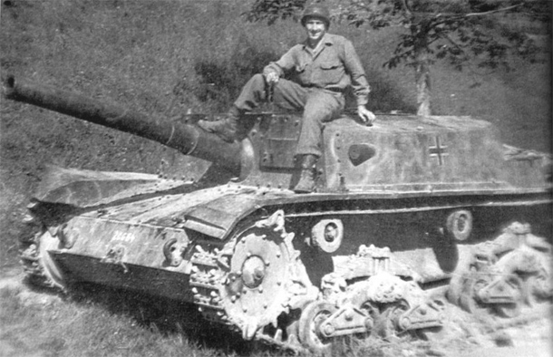

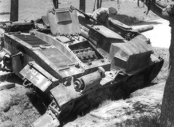

an American soldier beside the abandoned wreck of a Sturmgeschütz M43 mit 105/25 853(i); the four large teeth added to the drive sprocket as a measure against track slipping are clearly visible here, source: Worldwarphotos.info with the permission of the site operator, edited

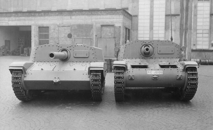

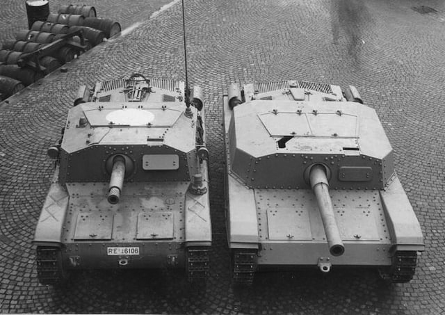

Ansaldo delivered its prototype in the second half of January 1943. Although the Semovente M42 served as the starting point, fairly substantial design changes were incorporated. First, the chassis had to be lengthened by 40 mm and widened by as much as 170 mm to accommodate the more powerful weapon. The designers nevertheless managed to reduce the vehicle's overall height by approximately 100 mm. The engine section was also shortened by 200 mm, which allowed the fighting compartment to be correspondingly lengthened. Further changes included the hull's front wall, which was now formed by the junction of two flat plates rather than a single curved one. As a result of all these modifications the vehicle earned its own designation, M43 — though the designation M42L is also apparently sometimes used, the L standing for Lungo, meaning "long". The new front hull configuration, as well as the different proportions of the older Semovente M42 with its 75 mm gun and the new M43 with its 105 mm howitzer, are clearly visible in the photographs HERE and HERE.

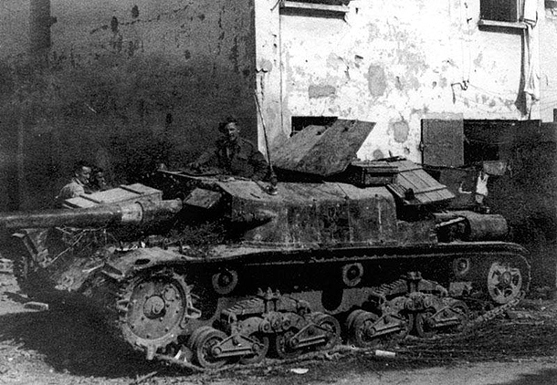

an Allied soldier beside a knocked-out Sturmgeschütz M43 mit 105/25 853(i); the Nebelkerzenabwurfvorrichtung smoke discharger bracket is clearly visible at the rear of the vehicle, source: Worldwarphotos.info with the permission of the site operator, edited

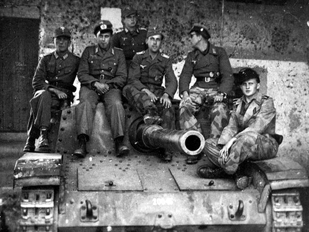

a Semovente M43 da 105/25 (or Sturmgeschütz M43 mit 105/25 853(i)) and its new owners, source: Worldwarphotos.info with the permission of the site operator, edited

In their assessment, the Germans criticised the Italian vehicle's thin armour, inadequate observation means and cramped fighting compartment. Overall, however, they considered it reasonably serviceable, and so decided to continue its production. For as part of Operation Achse they had also acquired the entire Ansaldo-Fossati production plant in Genoa. A further 91 of these self-propelled guns were therefore built before the end of the war, now exclusively for the German army. At the new customer's request, four large teeth were added to the front drive sprockets to prevent the tracks from slipping when under greater tension — for instance when driving on soft ground. Vehicles produced for the German army also most likely did not receive the side skirts protecting the upper portion of the track assembly.
