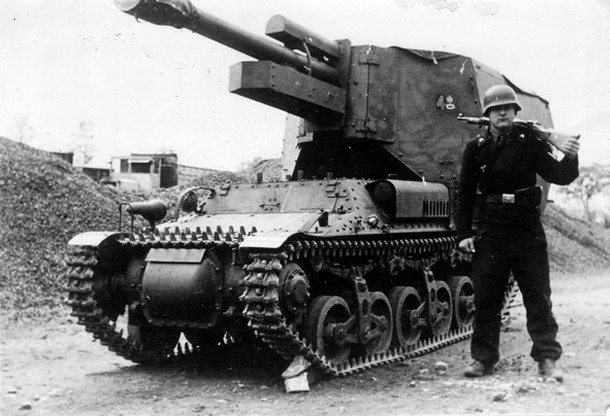

10,5 cm leFH 18 auf LORRAINE
self-propelled gun on a French tractor chassis
The 10.5 cm leFH 18/4 self-propelled gun on the Lorraine 37L French tractor chassis, here the Baukommando Becker version, source: Flickr.com, with permission of the publishing user, edited

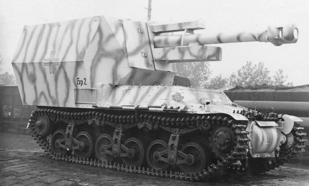

10.5 cm leFH 18/4 auf Geschützwagen Lorraine Schlepper (f) — here specifically the Alkett-built version

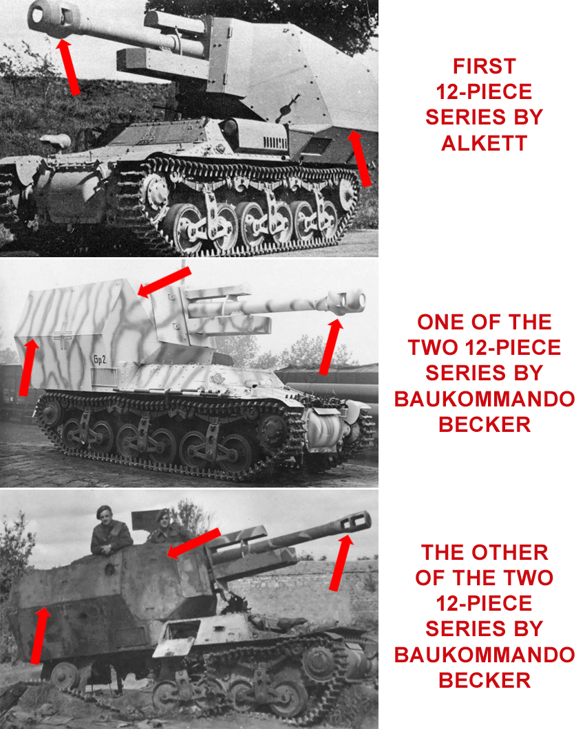

The first 12 leFH 18 self-propelled howitzers on the Lorraine tractor chassis were built to Becker's design by the firm Alkett, either in September or November 1942. By that time Alfred Becker was no longer working at Alkett. On behalf of the Ministry of Armaments he had relocated to France to head the so-called Baukommando Becker (sometimes also referred to as Baustab Becker) and organise the conversion of further usable captured equipment into fighting vehicles for the German Wehrmacht. It was in the workshops of Becker's Baukommando that a further 24 self-propelled guns of this type were built by September 1943, in two production batches of 12 each. The total production thus came to 36 vehicles — though they were not identical machines. Vehicles from each production batch differed slightly from one another, so photographs reveal, for example, three different configurations of the fighting compartment armour (see photo HERE). According to some authors, only 24 vehicles of this type were built — 12 by Alkett and 12 by the Baukommando.

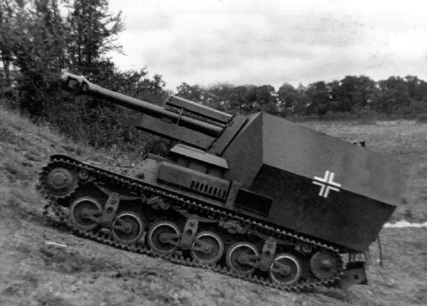

The French Lorraine 37L tractor (referred to by the Germans as the Lorraine Schlepper) had its engine located in the centre of the hull, with the rear reserved for the cargo compartment. For conversion into a self-propelled gun this was an ideal arrangement, since the rear section could be converted into a fighting compartment with relative ease — and that is exactly what happened. The front section of the hull was left essentially unchanged, with only the hot-air exhaust vents for the engine cooling air being moved from the roof to the sides, where louvred openings were cut into the armour for them. The running gear consisted on each side of six road wheels fitted with solid rubber tyres and suspended in pairs by leaf springs. At the front was the drive sprocket and at the rear the idler wheel. The tracks were only 22 cm wide.
Hull armour was thickest at the front at 12 mm, with 9 mm on the sides and only 6 mm on the floor and roof. The original French Delahaye 135 engine was of course also retained — a six-cylinder petrol unit with a displacement of 3.556 litres producing 70 horsepower — as was the original five-speed gearbox. The fighting compartment, formed at the rear of the vehicle, was enclosed by a tall protective shield welded and riveted from flat 10 mm plates. Armour of this thickness was insufficient even against armour-piercing rifle or machine gun rounds, offering protection only against ball ammunition and light shell fragments. Heavier armour was prevented by the chassis's limited load capacity. The original French Lorraine 37L tractor weighed 6.05 tonnes and could carry up to 810 kg of cargo in its load compartment. Its chassis was therefore rated for approximately 6.86 tonnes of direct load — yet the self-propelled gun weighed 7.7 tonnes. Remarkably, this does not appear to have had any adverse effect on driving performance, at least on paper. The vehicle's maximum speed remained the same as the original tractor's: 35 km/h.

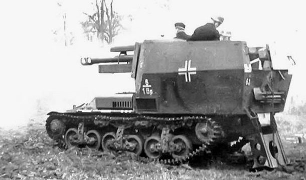

10.5 cm leFH 18/4 auf Geschützwagen Lorraine Schlepper (f) firing — note the folded-down rear stabiliser spade for better vehicle stability, source: Flickr.com, with permission of the publishing user, edited
Although it may not be immediately obvious, the gun was in fact positioned above approximately the rear third of the chassis, significantly shifting the vehicle's centre of gravity toward the rear. To reduce the stress on the rear of the running gear and to improve overall stability, a folding stabiliser spade was therefore fitted beneath the overhanging rear section of the fighting compartment. During travel it was raised against the rear armour plate; before firing it was lowered to the ground. As for the combat deployment, only the fate of 24 vehicles is known — those assigned to Panzer Artillerie Regiment 155 of the 21st Panzer Division. In June 1944 all of them were committed against the Allies following the Normandy landings. Their numbers gradually dwindled, and the last were lost in the Falaise Pocket in August 1944.

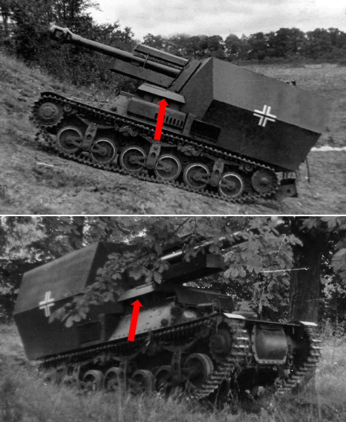

As an aside, photographs exist that show at least one example of the 10.5 cm leFH 18/40 auf Geschützwagen Lorraine Schlepper with an interesting modification that no published source mentions. Above the hull roof, directly in front of the fighting compartment, an additional raised hood of some kind appeared. Since the engine air intake louvres were located in precisely this area, it is possible that this was a "shield" intended to protect the engine compartment — perhaps against shell splinters, or possibly against rainwater. Whether it was an experimental installation on just one vehicle or whether more vehicles were modified in this way is unfortunately unknown. A photograph of this modified self-propelled gun can be viewed HERE.
