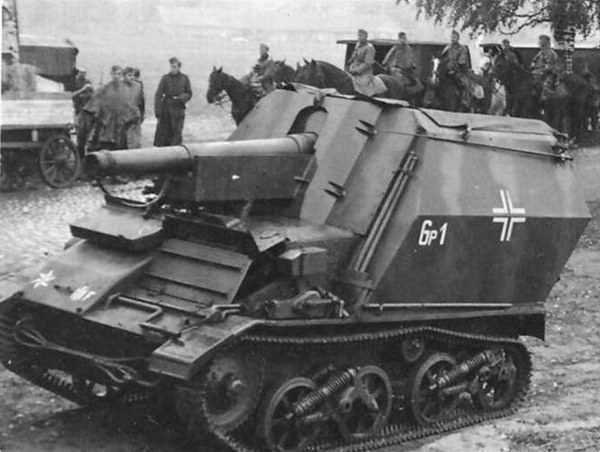

10.5cm leFH 16 auf Geschützwagen Mk. VI(e) — visible on the armour is the so-called Scotti Stern, the insignia of the Wehrmacht's 227th Infantry Division, source: Flickr.com, with permission of the publishing user, edited

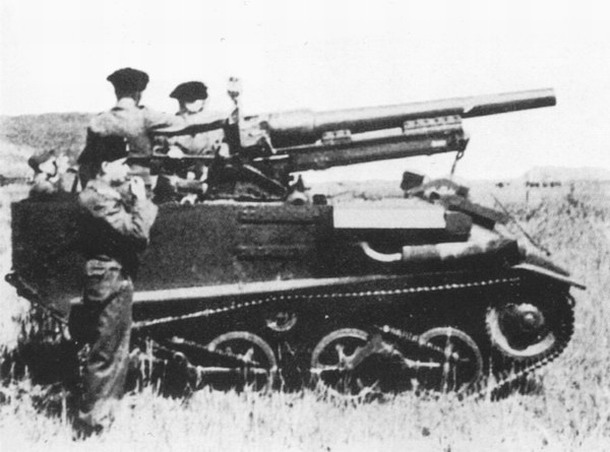

Firing trials on the first incomplete prototype confirmed that the British light tank chassis could carry the German 105 mm howitzer without difficulty, source: Flickr.com, with permission of the publishing user, edited
The armament chosen for the new fighting vehicle was the 105 mm leFH 16 light howitzer — a First World War-era weapon for which this was essentially an ideal new purpose. Becker planned to enclose the crew's fighting space with light armour on all sides. First, however, it was necessary to verify whether the chassis could actually carry the chosen howitzer and withstand the stresses produced by its firing. Initial driving and firing trials were therefore carried out on the vehicle with an open, unarmoured cab. On the basis of these trials, a folding stabiliser spade was fitted to the rear of the hull to improve stability during firing. The overall behaviour of the test vehicle was satisfactory, and development work could continue.

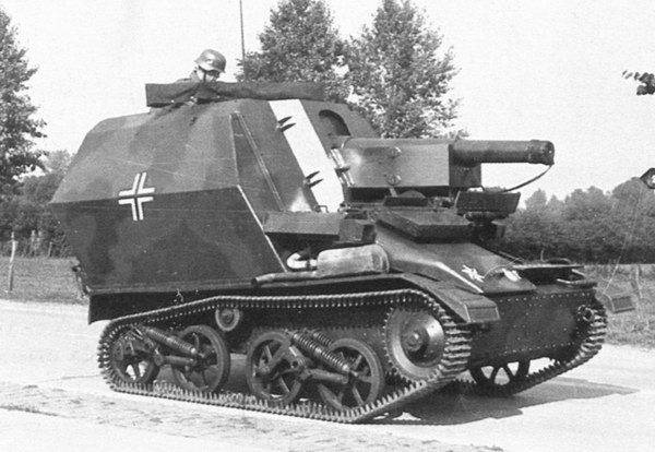

However things stood, Krefelder Stahlwerke delivered the ordered components and Becker's men were able, over the following six months, to slowly but surely build 12 leFH 16 self-propelled howitzers on the Vickers Mk. VI tank chassis. The chassis used for the conversion were probably those of the B and C variants of the tank, which were not visually very different from one another. From the British tank, the German self-propelled gun inherited a chassis with four road wheels sprung in pairs by coil springs, a six-cylinder Meadows petrol engine producing 88 horsepower, a Wilson five-speed gearbox, and a hull with a maximum armour thickness of only 14 mm.

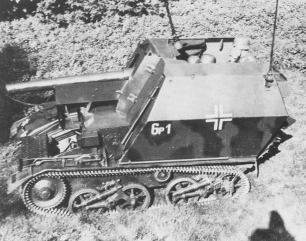

10.5cm leFH 16 auf Geschützwagen Mk. VI(e), source: Flickr.com, with permission of the publishing user, edited
In the rear half of the vehicle a fixed fighting compartment was welded from armour plates — 14 mm thick on the sides and rear, and 22 mm at the front. Armour of this thickness was capable of stopping 7.92 mm armour-piercing rounds and light shell splinters. Given the vehicle's combat role, this was a reasonably adequate level of protection. The self-propelled gun was not intended for direct close-range combat; like conventional artillery, it was to remain behind the front-line units and provide fire support from a relatively safe distance, firing over the heads of its own troops. An opening in the front wall of the fighting compartment allowed limited vertical and horizontal movement of the weapon. Most surviving photographs show these self-propelled guns with armour protection over the recoil mechanism beneath the barrel, but there are also photographs in which this protection is absent, and the vehicles otherwise appear completely intact — suggesting these were not battle losses of that component. It is therefore possible that early examples simply did not yet have the recoil mechanism armour and it was only added at a later stage (photo HERE).

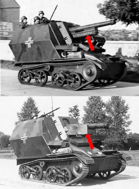

The standard towed leFH 16 howitzer in 105 mm calibre could theoretically fire 14.81 kg high-explosive fragmentation shells to a maximum range of 9,225 metres. In the self-propelled installation, however, the effective maximum range was probably lower, for two reasons. To the naked eye, the front wall of the fighting compartment appears to have restricted the gun's maximum elevation compared with the standard towed howitzer, which would naturally reduce the range. What certainly did limit the range was the prohibition on using the heaviest propellant charge — number 6. The howitzer used separate-loading ammunition, meaning the shell was first rammed into the barrel followed by the cartridge case, into which varying amounts of propellant could be inserted (in the form of a varying number of powder bags). The British light tank chassis was not particularly robust, and firing with the heaviest charge would have placed excessive strain on it. The rule was therefore that firing with charges 1 through 3 required no special precautions; firing with charges 4 and 5 was only permitted with the stabiliser spade lowered (the spade was mounted on the rear wall of the hull); and firing with charge 6 was prohibited altogether.

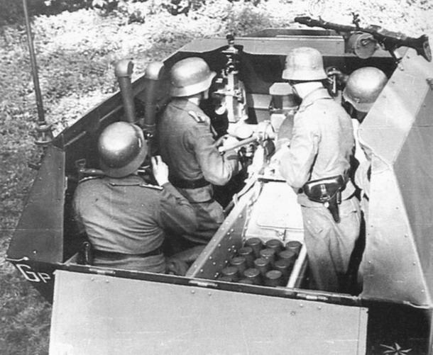

The crew of the self-propelled gun apparently consisted of four soldiers: a driver, seated separately in the left front section of the hull, plus a commander, gunner and loader. Surviving photographs show that for firing, the driver moved from his normal position into the fighting compartment, where he apparently assisted with loading. The vehicle commander had his station in the left rear corner of the compartment, with a scissors-type artillery periscope as his primary observation device. In front of the commander sat the gunner, who aimed the weapon using the Z.E. 34 periscopic sight. To the left of the gunner, a Fu.Spr.Gr. radio set was mounted on the side wall of the compartment, connected to a whip antenna in the rear corner. To the right of the gun, an MG 34 machine gun could be mounted on the edge of the front wall, providing a means of defence against enemy infantry. The fighting compartment was open at the top, which aided ventilation as well as aiming and ammunition handling. Entry was over the rear wall, whose upper half could be folded down. How much ammunition the self-propelled howitzer actually carried is not entirely clear from the sources; photographs of the interior show at least 15 shells stowed in the centre of the compartment, 8 shells along the left wall and 8 along the right — 31 rounds in total.
When preparing to fire, the driver would move from his station into the fighting compartment to help with loading the howitzer, source: Flickr.com, with permission of the publishing user, edited

Four men had precious little room to spare in the fighting compartment, source: Flickr.com, with permission of the publishing user, edited
