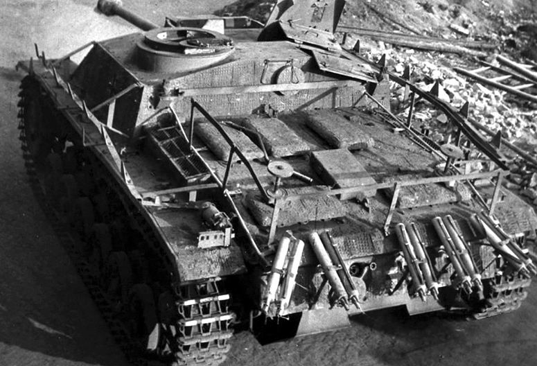

The photographed StuG III carried ten of these flamethrowers, all pointing rearward. Along both sides of the engine deck ran tubes through which steel cables were routed from inside the fighting compartment to the triggers of the individual flamethrowers. The right-hand tube apparently carried six cables to the flamethrowers on the right side, while the left-hand tube carried only four cables to those on the left. The steel cables entered the fighting compartment through holes drilled in the rear wall where the radio antenna cables were fed through. The vehicle chosen for the experiment was therefore most likely a command variant of the StuG III, which had provision for two antennas on its rear wall – meaning two brackets and two cable glands already in place.

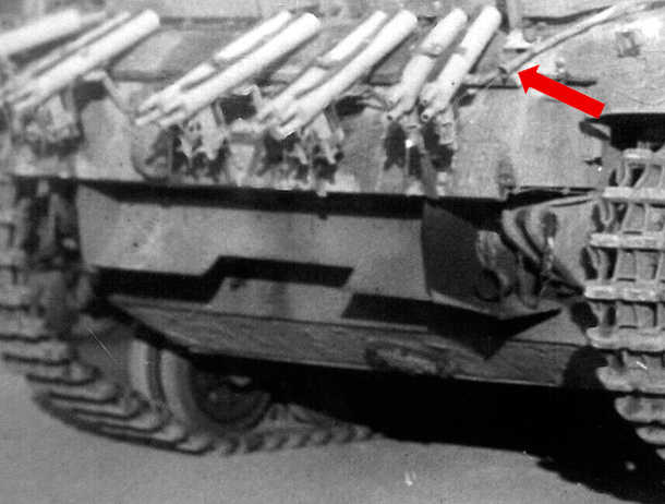

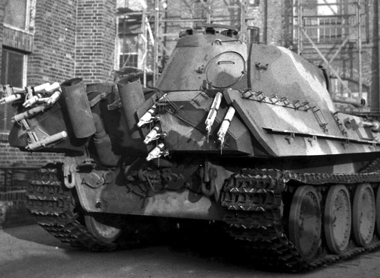

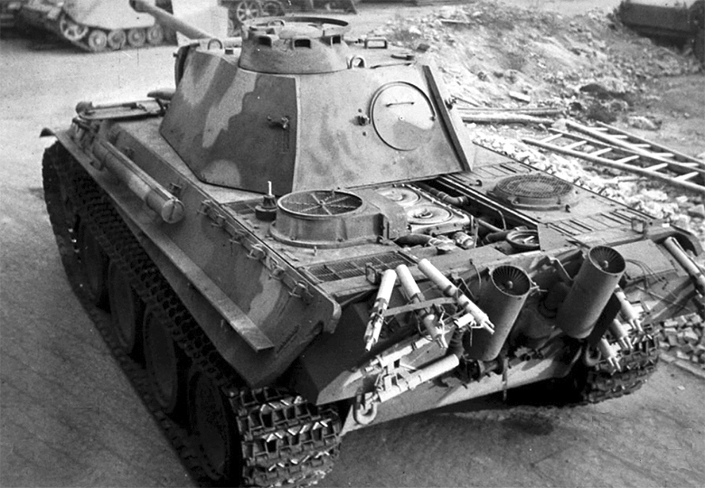

The Panther tank was also fitted with a total of ten single-shot flamethrowers, attached to the stowage bins on the rear hull wall – five on the left bin and five on the right. What is interesting, however, is that the flamethrowers were not arranged symmetrically on the two sides. It appears the designers were experimenting with different mounting positions and angles of fire. How else to explain that the flamethrowers on the right side are mounted nearly parallel to one another and all point directly rearward, while those on the left point both rearward and to the side, fanned out in a spread pattern? The steel cables used to fire the flamethrowers remotely are also visible in the photographs of the tank. In this case the cables appear to disappear somewhere beneath the engine deck and are then routed through the engine compartment and its firewall into the fighting compartment.
StuG III Ausf. G assault gun with Einstossflammenwerfer 46 single-shot flamethrowers fitted to the rear; source: Flickr.com, edited

the Panther tank again – note that the flamethrowers on the left and right sides of the vehicle are arranged differently from one another; source: Flickr.com, edited

More informative in this respect is the Panther tank. This one may well have been a newly built vehicle, so it makes sense to look at specific details that can help narrow down its production period. The tank has no Zimmerit (meaning it was produced after September 1944). The raised cover over the left cooling fan is part of the fighting compartment heating system (Kampfraumheizung), which was introduced in October 1944. The tank is fitted with flame suppressors on the ends of its exhaust pipes (Flammenvernichter), which only began to be installed in practice from December 1944. And finally, the tank has a commander's cupola with a machine gun ring mount, which ceased to be fitted at the turn of January and February 1945.
a close-up view of the rear of the StuG III assault gun shows the protective tube through which the steel cables connected to the flamethrower triggers were routed; source: Flickr.com, edited
