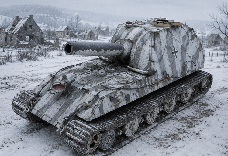

The Bär self-propelled mortar amid the ruins of a German city in the final stages of the war; background: internet (public domain), plastic model: Canuck2016 (uamf.org.uk), composite: Panzernet

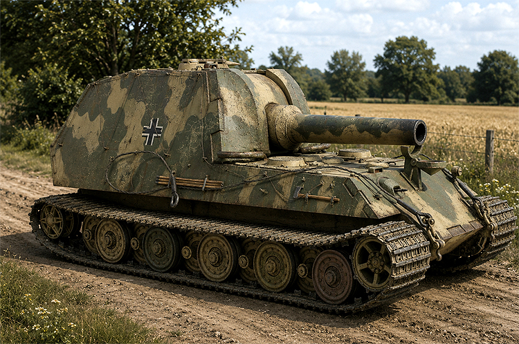

A knocked-out Bär mortar amid the ruins of a city captured by the Red Army; background: internet (public domain), plastic model: Canuck2016 (uamf.org.uk), composite: Panzernet

The self-propelled gun under development was given the easily memorable name "Bär" — meaning bear. Its chassis was to have ten axles on each side for interleaved road wheels. These were all-steel, fitted only with a thin rubber tyre concealed beneath a steel rim. Torsion bar suspension — the standard solution on heavy German vehicles, including the Tiger II — could not be used here. Conventional torsion bars ran transversely across the floor of the hull tub. The Bär's designers, however, needed to create a large opening in the hull floor for the gun's recoil travel, and that was incompatible with torsion bars.
This drawing of the Bär self-propelled mortar clearly shows the internal crane for handling shells and the gun's recoil travel into the open floor section, source: Flickr.com, edited
The vehicle's hull was to have a sloped front plate 130 mm thick. Some illustrations show a hull machine gun embrasure in the front plate, but the Krupp drawing from November 1944 shows no hull machine gun (though it is a very simplified drawing). The hull sides were to be 80 mm thick. The driver and radio operator had their stations in the front section of the hull, each with their own overhead entry hatch. Behind them lay the engine compartment, with the engine itself mounted centrally and the radiators on either side. The gearbox was located between the driver and the radio operator.

At the rear of the hull was the fighting compartment, with a rounded front wall featuring a large opening for the gun barrel. The vehicle's armament was to consist of a heavy 305 mm mortar with a barrel length of 16 calibres. This was to be a modified (and lengthened) version of the originally Czechoslovak vz. 16 mortar from Škoda Plzeň. The weapon itself weighed approximately 8 tonnes, its mounting a further 6 tonnes, and the massive rounded gun shield 2.5 tonnes. The mounting allowed the mortar to vary its vertical elevation from 0° to +70°, though lateral traverse was only 2 degrees to each side. The weapon was to use two types of ammunition: the high-explosive fragmentation Sprenggranate, weighing 350 kg, left the barrel at 355 m/s and could reach a target up to 10.5 km away; while the armour-piercing Betongranate, weighing 380 kg, had a muzzle velocity of 345 m/s and a maximum range of 10 km.
Firing such a heavy weapon produced an enormous recoil force, which had to be absorbed by a recoil stroke of a full 100 cm. This brings us gradually to the explanation of why the designers needed to create that large opening in the hull floor. A mortar is by its nature a weapon designed to destroy fortifications, and it typically fires at high elevation angles so that the shell arrives at the target from a steep trajectory, thereby gaining high velocity and energy on impact. It was precisely when firing at a high angle that the long recoil stroke became a problem, because after the shot the breech would slam into the floor of the fighting compartment. In theory the problem could have been solved by mounting the weapon on a taller carriage, but this would have pushed the already enormous overall height of the vehicle even higher. The other theoretical solution — lowering the floor of the fighting compartment — would in turn have reduced the vehicle's ground clearance and therefore its cross-country mobility. The designers therefore came up with the idea of an openable floor section. A portion of the floor at the rear of the fighting compartment could be lowered all the way to the ground, and it was into this space that the barrel was to recoil when firing.

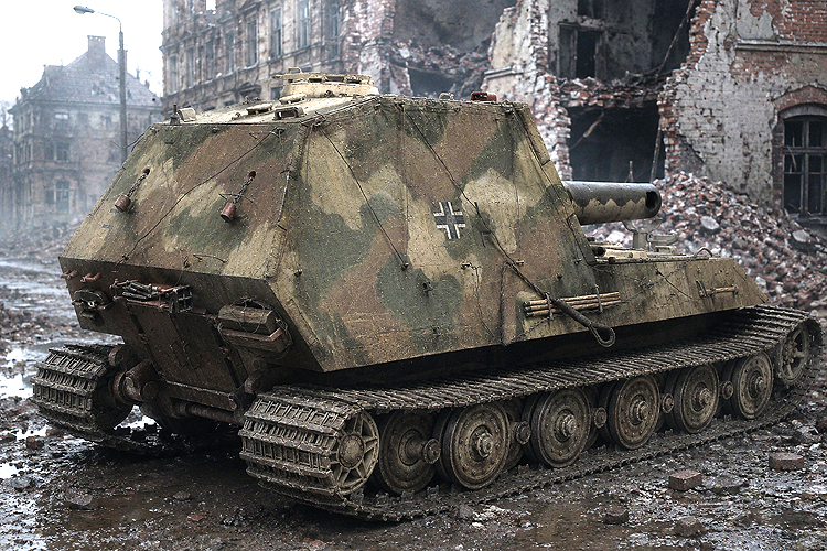

Rear view of the Bär self-propelled mortar — note the crew access doors; background: internet (public domain), plastic model: Canuck2016 (uamf.org.uk), composite: Panzernet
The Bär self-propelled gun was designed to be 8.2 metres long, of which 5.3 metres was the ground contact length of the tracks. With a track gauge of 3.1 metres, this gave a not particularly comfortable turning ratio of 1.71. The track contact length when sinking 20 cm into soft ground (i.e. off-road) increased further to approximately 5.9 metres, worsening the ratio relative to the track gauge to 1.9. Two types of tracks were planned for the vehicle: combat tracks 100 cm wide and transport tracks only 50 cm wide. The transport tracks were used when travelling by rail, so that the vehicle fitted within the prescribed loading gauge limits. The Bär was designed to stand 3.55 metres tall and 4.1 metres wide with combat tracks, or 3.27 metres with transport tracks. The firing height of the mortar was 2.4 metres. The vehicle's total combat weight was calculated at 120 tonnes, and its maximum speed was expected to be around 20 km/h. With the wide combat tracks fitted, the ground pressure (the figure derived from the ratio of weight to the track contact area with the ground) was expected to be around 1.02 kg/cm² (assuming 20 cm of ground penetration).
The vehicle's crew was to consist of six men. In addition to the already-mentioned driver and radio operator in the hull, there were a commander, gunner and two loaders in the fighting compartment. Two hatches in the roof of the compartment served as the crew's entry and exit points; their covers were to be fitted all around with observation periscopes. A large opening in the rear wall of the compartment would probably have been provided for ammunition loading. Given the shell weights quoted above, it is clear that loading the gun could under no circumstances have been purely manual work. A simple overhead crane was therefore to be suspended from the roof of the fighting compartment to assist with ammunition handling. Only 10 shells could be stowed on board, after which the Bär had to replenish its ammunition from a supply vehicle. In practice, those 10 rounds were not quite as meagre a supply as they might seem. The rate of fire was very low, since after every shot the barrel had to be depressed back to the loading position, and the handling of the shells themselves was also a fairly slow process. The risk of the Bär running out of ammunition too quickly was therefore decidedly remote.
