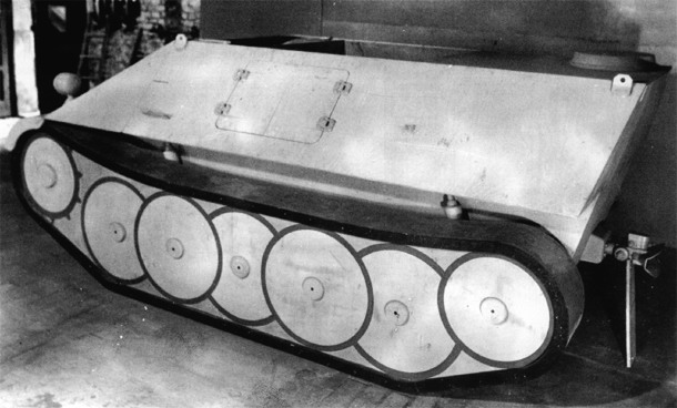

wooden mock-up of the VK 5.01 ammunition carrier, built in June 1943; the hull's strong resemblance to the Panther tank is unmistakable, source: aviarmor.net, edited

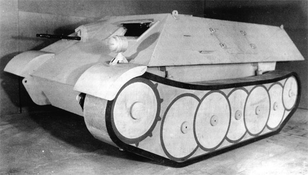

wooden mock-up of the VK 5.01 ammunition carrier; the originally proposed side doors were later replaced by large doors in the rear wall, source: aviarmor.net, edited

As the next step towards a prototype, a full-size wooden mock-up of the vehicle was ordered from Weserhütte. After studying it in June 1943, the Waffenamt came back with several change requests. The overall height of the vehicle was to be reduced from 1,690 to 1,550 mm and the engine was to be moved to the left side. Large entry doors were then to be provided on the right side of the rear wall. The soldiers considered this a better solution than the double-leaf doors in the side walls — large doors at the rear could serve not only for crew entry and exit and ammunition loading and unloading, but also for loading a wounded man on a stretcher. The armoured vehicle could therefore bring ammunition to the battlefield and return with at least one casualty on board.

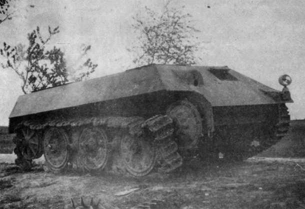

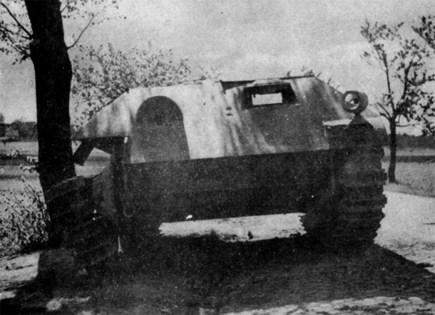

According to some sources, the production of three prototypes was ordered — one with torsion bar suspension and two with coil springs — apparently so the army could compare both systems. The literature unfortunately provides no details about the subsequent development and production of the VK 5.01. Some information is available from another source, however. A single example of the vehicle was found by soldiers of the US First Army in the Ruhr in the very final stages of the war. The intelligence officer summoned to examine it, Captain G. D. Drury, inspected the damaged vehicle and recorded his findings in a report dated 19 May 1945.
The report states, among other things, that the vehicle examined had its road wheels sprung by torsion bars — consistent with the information above regarding three prototypes with different suspension systems. A particularly interesting point is that the engine compartment was not positioned on the left side as the Weapons Office had requested in June 1943, but on the right. The entry doors were consequently located on the left side of the rear wall. The report further notes that the vehicle had a four-speed forward and one reverse gearbox, and four interconnected fuel tanks with a combined capacity of approximately 230 litres. How many examples were ultimately built remains an unanswered question.
