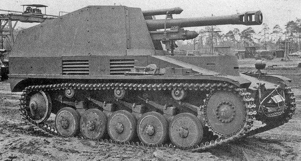

Series production Wespe vehicles were based on a modified version of the PzKpfw II Ausf. F light tank chassis. The main modification was relocation of the powerplant from the rear of the hull to the centre. Louvred openings were cut in the side walls of the superstructure to allow cooling air to flow to the engine and its radiator. The running gear consisted on each side of five 550 mm diameter rubber-tyred road wheels for a smoother ride. The wheels were individually suspended and sprung by leaf springs. Since the self-propelled gun was heavier than the original tank, the springs on the first, second and fifth road wheel positions were fitted with rubber bump stops to limit maximum spring deflection and prevent failure under overload. At the front of the track assembly was the toothed drive sprocket and at the rear the idler wheel. The upper run of the track was supported by small return rollers, the number of which was reduced from four on the original Panzer II Ausf. F to just three. The modified tank chassis received the designation Geschützwagen II (Geschützwagen — literally "gun carriage").
Wespe, source: worldwarphotos.info, with permission of the operator, edited
The powerplant was taken over from the original tank — the six-cylinder Maybach HL 62 TR petrol engine with a displacement of 6.191 litres, producing a maximum of 140 horsepower at 2,600 rpm. Two fuel tanks under the fighting compartment floor held a combined 200 litres of petrol. Connected to the engine was the Zahnradfabrik SSG 46 gearbox with six forward gears and one reverse, housed on the right in the front section of the hull. To the left of it was the driver's station. The driver had something of a small cab of his own, the armour of which projected from the steeply angled glacis plate of the hull.
The driver's view of the road ahead was provided by three vision ports. The main one was naturally in the wall directly in front of him. When moving in a safe area, the driver could open this port fully for a reasonably unobstructed view ahead. In combat areas the cover stayed closed and the driver looked out only through an elongated slit protected internally by a block of bulletproof glass. In each side wall of the driver's cab there was also a small slit-type vision port. The driver's entry and exit hatch was directly above his head in the roof.
Approximately midway along the hull began the main fighting compartment, protected by a tall armoured shield. The armour was highest at the front and tapered toward the rear down to a comparatively low rear wall. The top of the fighting compartment was left completely open. In bad weather the crew could shelter by pulling a waterproof tarpaulin over the opening.

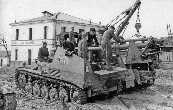

Inside the fighting compartment was installed the 105 mm leFH 18 (leichte Feldhaubitze) light field howitzer — more precisely the leFH 18/2, a variant adapted specifically for installation in a self-propelled gun. The howitzer fired 14.81 kg high-explosive fragmentation shells to a range of up to ten kilometres. 32 rounds of ammunition were stowed on board. A supplementary MG 34 machine gun was carried by the crew in the compartment, from which fire could be directed over the top of the armour walls. Two MP 38 or MP 40 submachine guns were also carried.
Wespe during gun removal, source: Flickr.com, with permission of the publishing user, edited
The central section of the fighting compartment's front wall was connected to the howitzer and traversed with it when the barrel was moved laterally. When it comes to the weapon's range of movement, the literature is rather confused. The vertical elevation range is sometimes given as -10° to +40° and sometimes as -5° to +42°. Information on horizontal traverse is even less reliable — in one source the howitzer can traverse up to 35 degrees to each side, in another only 20 degrees to each side, and some authors give as little as 17 degrees to each side.

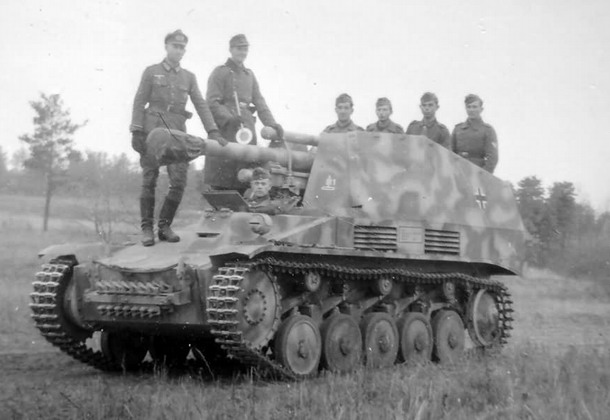

Series production of the Wespe was entrusted to the firm FAMO (Fahrzeug und Motoren Werke GmbH) in Wrocław, Poland (German: Breslau), and its subsidiary plant Ursus in Warsaw. The first two examples of the new vehicle were completed in February 1943 and production continued until June 1944. During this period, 676 armed self-propelled guns and a further 159 unarmed ammunition carriers came off the production lines.

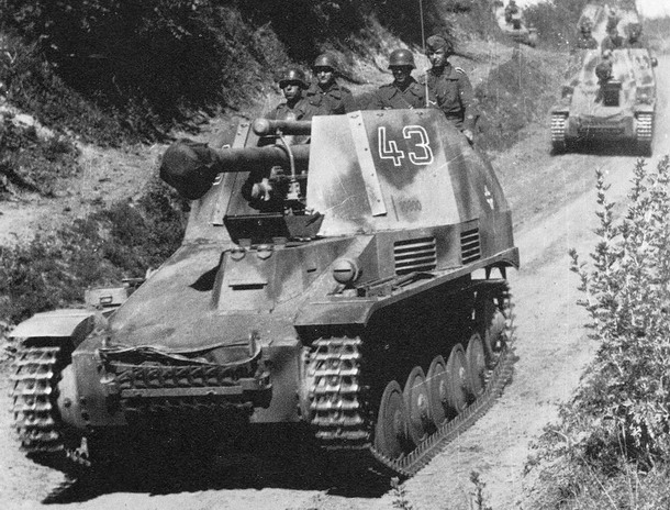

The first panzer divisions began receiving their Wespe vehicles in the spring of 1943. The new self-propelled gun's first major combat deployment was the Kursk offensive in the summer of 1943. From then on the Wespe fought on both the Eastern and Western Fronts until the end of the war. Combat unit reports on experience with this self-propelled howitzer contained both praise and criticism. On the Eastern Front, a general quality of self-propelled artillery was viewed very positively: the ability to strike unexpectedly and then disappear. The Wespe could simply surprise the enemy with fire from an unexpected location and pull out before the enemy's counter-battery fire arrived. Criticism, on the other hand, was directed at the small ammunition supply. Given that the Wespe fired indirectly at greater distances, it required large quantities of ammunition. The 32 rounds on board were therefore seen more as an emergency minimum, and continuous resupply with additional ammunition was an absolute necessity.
Unarmed Wespe Munitions Schlepper ammunition carrier, source: Flickr.com, with permission of the publishing user, edited

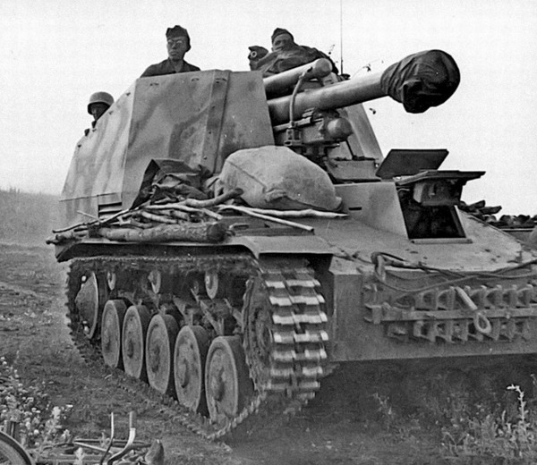

While reports from the Eastern Front mentioned no significant technical problems, units fighting in Italy complained strongly about a range of difficulties. The reason was the mountainous terrain in which the Wespe was deployed there. Soldiers grumbled about the vehicle's weak engine, which made it slow when climbing hills — and the strain on the engine also led to more frequent overheating and breakdowns. This applied not only to the engine but also to the steering mechanism, which suffered in the sharp bends of mountain roads. Complaints were also heard about the cramped space inside the fighting compartment: the crews simply had nowhere to put their personal belongings, blankets, mess kits, toiletries and the like.
