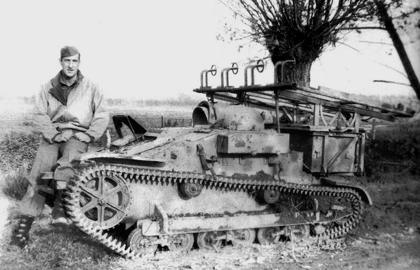

28/32cm Wurfrahmen auf Infanterieschlepper UE; source: Flickr.com, published with the permission of the original contributor, edited

28/32cm Wurfrahmen auf Infanterieschlepper UE captured by American forces in France; source: internet, Public domain, edited

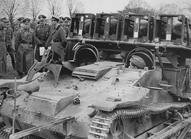

The rocket launcher existed in two variants. In the first, the rocket frame was installed directly above the original rear cargo compartment. This frame, welded from steel tubing, held four rockets — either 280 mm high-explosive or 320 mm incendiary. The second variant carried the rocket frames on the sides of the vehicle. The individual rocket cages were hung on a tubular structure similar to the one used on the half-tracked Sd.Kfz. 251. This variant also carried four rockets.
