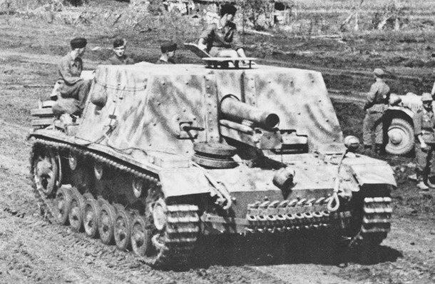

Summer 1943 — a SIG 33, or Sturminfanteriegeschütz 33, advancing with the 23rd Panzer Division through the Russian countryside, source: worldwarphotos.info, with permission of the operator, edited

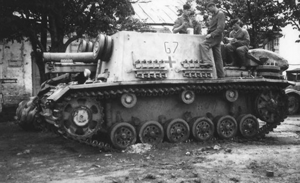

Probably one of the twelve Sturminfanteriegeschütz 33 that managed to reach Stalingrad before the encirclement, source: worldwarphotos.info, with permission of the operator, edited

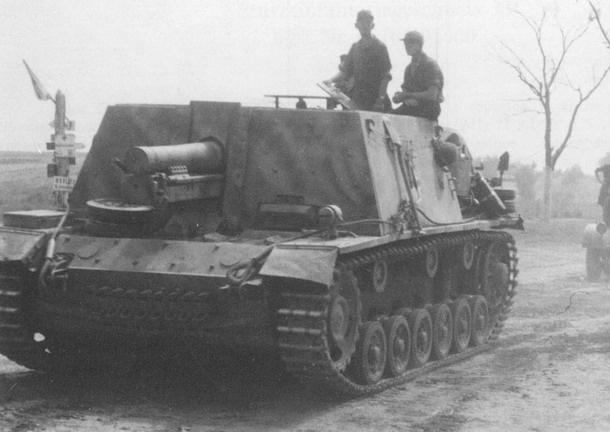

Sturminfanteriegeschütz 33, summer 1943, source: Flickr.com, with permission of the publishing user, edited

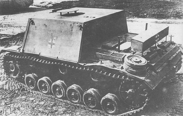

As its basis, older used chassis from StuG III assault guns of various variants (from Ausf. B through Ausf. E) were used — vehicles returning to Alkett from the front for major overhaul. The standard StuG III had a hull front plate 50 mm thick, which was considered insufficient for the new vehicle. An additional 30 mm armour plate was therefore bolted to the front of the Sturminfanteriegeschütz 33's hull.

The running gear consisted on each side of six road wheels sprung by torsion bars. The wheels were 520 mm in diameter and fitted with rubber tyres for a smoother ride. They were double wheels with the track guide teeth running between the two discs. The first and last road wheel on each side had an additional damper (as these wheels were subjected to the greatest stress during travel). At the front was the toothed drive sprocket and at the rear the idler wheel. The upper run of the track was supported by three 310 mm diameter return rollers. The tracks were 380 mm wide.
In place of the original low fighting compartment of the StuG III, a significantly larger compartment was fitted, welded from flat armour plates. The compartment was wide enough to extend over the track guards on both sides. These, however, were too thin to provide a solid floor for the compartment, so they were reinforced with additional 15 mm plates. On the left side, a section of the original StuG III front wall was retained, containing the driver's vision port. The front wall of the new fighting compartment adjoined this section — with a corresponding cutout at that point. Slightly to the right of centre, the barrel of the sIG 33 passed through the front wall. Connected to the barrel was a separate armour plate, mounted in guide rails on either side. This plate moved up and down together with the gun barrel during aiming. Below the barrel there was a further small movable armour plate. When the barrel was horizontal or only slightly elevated, this plate lay folded down beneath it. When the barrel was raised to a greater angle, this plate also rose, closing the open space beneath the gun barrel. The design of the front wall allowed horizontal traverse of a mere 3 degrees to each side. Vertical elevation ranged from -3° to +25°. To the left of the gun in the front wall was an MG 34 machine gun embrasure, taken from the PzKpfw III tank.
In the right side wall of the fighting compartment there was a small opening for emergency use by the crew's personal weapons, sealed by a metal plug. The rear wall had two crew entry hatches, and there was a further hatch in the roof plate. The roof also had an oval opening through which the gun's periscopic sight extended, protected by a raised sheet-metal hood. Beside it, a circular opening was cut for the installation of a ventilator fan — though as far as is known, fans were never actually fitted and the circular opening was simply welded shut again. The front wall of the fighting compartment was 80 mm thick and angled at 9 degrees. The side walls were 50 mm thick at 15 degrees, and the rear wall was 30 mm thick (15 mm is also sometimes cited). The roof was 20 mm thick (10 mm is also sometimes cited).

Behind the fighting compartment came the engine compartment, housing the twelve-cylinder Maybach HL 120 TRM petrol engine with a displacement of 11.9 litres, producing a maximum of 300 horsepower at 3,000 rpm. A driveshaft ran from the engine to the gearbox at the front of the hull. The gearbox was the Zahnradfabrik SSG 77 type with six forward gears and one reverse. Fuel capacity was 310 litres. The Sturminfanteriegeschütz 33 weighed approximately 21 tonnes and could achieve a top speed of around 40 km/h. Only 30 rounds of gun ammunition could be stowed on board — though given the vehicle's purpose, this was not a serious handicap. 600 rounds of MG 34 machine gun ammunition were carried. The crew consisted of five men: driver, commander, gunner and two gun loaders. A Fu 5 radio set was installed. Photographs confirm that some vehicles were fitted with wide winter tracks.

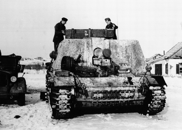

The first twelve Sturminfanteriegeschütz 33 produced were dispatched east immediately. At the end of October 1942 they arrived in the area of the River Chir, approximately a hundred kilometres west of Stalingrad. The vehicles were split equally between two assault gun battalions: Sturmgeschütz-Abteilung 177 and Sturmgeschütz-Abteilung 244. Both battalions received orders to deploy these vehicles in Stalingrad without delay, which they did. At the beginning of November 1942, six of the vehicles took part in Operation Hubertus — an attempt to destroy the last positions of the Soviet 62nd Army in the northern part of the city on the west bank of the Volga. The Sturminfanteriegeschütz 33 also fought in other parts of the city, including the centre itself. Details are essentially unavailable, but all 12 vehicles were lost in Stalingrad along with the rest of the encircled forces.
When the next twelve vehicles — built in November 1942 — arrived at the front, Stalingrad was already encircled, so these vehicles could no longer enter the city. They were instead committed to the attempt to break the encirclement from outside, as part of the specially formed Sturminfanteriegeschütz Lehr Bataillon XVII, fighting alongside the 22nd Panzer Division. The attempt to break through the pocket failed. In the weeks and months that followed, the Sturminfanteriegeschütz 33 fought in the retreating battles on the southern sector of the Russian front. On 11 April 1943 the last seven surviving examples were all transferred to the 23rd Panzer Division. According to that division's records, the last vehicle of this type was lost in October 1943 (some authors suggest that these vehicles appeared in a report as late as September 1944, but this is highly unlikely).

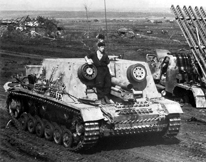

A Sturminfanteriegeschütz 33 passing the wreck of a Soviet Katyusha rocket launcher, source: Flickr.com, with permission of the publishing user, edited
In November 1943 a report was compiled summarising operational experience with these vehicles. Among other findings, the report noted that the vehicle lacked adequate observation devices — a fair criticism, since beyond the driver's vision port there was only the gun's periscopic sight. Crews requested the installation of at least a binocular observation periscope. The horizontal traverse of the gun — three degrees to each side — was also deemed insufficient. The use of older, already-worn-out chassis was viewed critically: the accumulated wear manifested itself in frequent failures of the engines, drivetrain, running gear and tracks. The destructive power of the main weapon, on the other hand, was assessed entirely positively.
