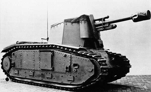

A brand-new example of the 10.5 cm leFH 18/3 auf Geschützwagen B2 self-propelled gun — note the tarpaulin stretched over the open fighting compartment, source: Flickr.com, with permission of the publishing user, edited

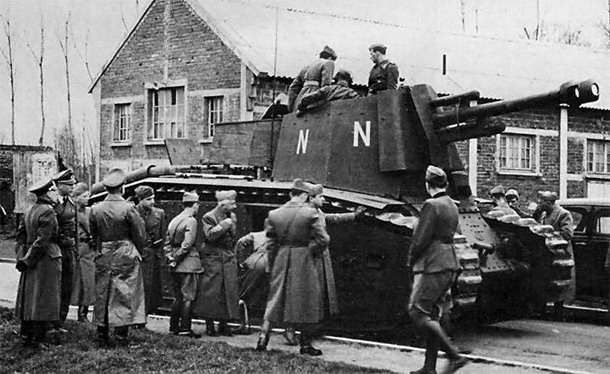

Individual self-propelled guns were rather unusually identified by large letters painted on the sides of the fighting compartments, source: Flickr.com, with permission of the publishing user, edited

The conversion of the French tank into a self-propelled gun was fairly straightforward. The 75 mm hull gun was removed and the opening in the front plate was blanked off with a piece of armour. The original fighting turret was also removed, and in its place a tall fixed superstructure appeared, enclosing the newly created fighting compartment. The walls of this superstructure were 30 to 40 mm thick at the front and 20 to 30 mm on the sides and rear — genuinely generous protection given the vehicle's intended role, since the self-propelled gun was not meant to engage the enemy directly but to provide fire support from a degree of "safe" distance. The roof of the superstructure was left open, which made aiming easier, improved ventilation and allowed freer movement and easier ammunition handling within the fighting compartment. The corresponding section of the tank hull roof was most likely also modified to serve as the floor of the new fighting space.

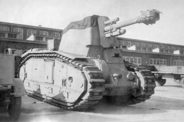

A 10.5 cm leFH 18/3 auf Geschützwagen B2, probably in the courtyard of the 26th Panzer Division's barracks in France, source: Flickr.com, with permission of the publishing user, edited
Inside the fighting compartment the 105 mm leFH 18/3 light howitzer was installed. The front wall of the fighting cabin was formed by a two-part movable gun shield connected to the barrel. The larger section of the shield maintained the integrity of the armour protection as the gun traversed horizontally, while the smaller section did the same during vertical movement of the barrel. Horizontal traverse was 14 degrees to each side; vertical elevation ranged from -5° to +20°. The howitzer used separate-loading ammunition, meaning the shell was rammed first followed by the cartridge with its propellant charge. The range could be adjusted by varying the size of the propellant charge — that is, the number of powder bags inserted into the cartridge, with six charge sizes available on the standard towed leFH 18, the largest of which gave a range of around 10,675 metres. It is quite possible that on the self-propelled variant the use of the heaviest charge was prohibited (this was not unusual practice). The standard 105 mm high-explosive fragmentation shell weighed 14.81 kg, of which 1.38 kg was the TNT filling. How many rounds of artillery ammunition could be carried aboard the self-propelled gun is unfortunately not known from the available sources.
The 10.5 cm leFH 18/3 (Sf.) auf Geschützwagen B2 self-propelled howitzer weighed 32.5 tonnes — a full tonne more than the original French Char B1 bis tank. Compared to the tank, however, both the length and height also increased. The overall length of the self-propelled gun was 762 cm, against 637 cm for the original tank — the entire increase being accounted for by the gun barrel projecting beyond the hull outline. The vehicle's height rose from 279 cm on the original tank to an even 300 cm on the self-propelled howitzer. An already tall vehicle thus became taller still, and consequently a more conspicuous target. The remaining dimensions of the self-propelled gun stayed more or less the same as those of the ex-French tank: width 246 cm, maximum speed approximately 25 km/h, a Renault engine producing 309 horsepower, a five-speed gearbox, and fuel tanks with a combined capacity of 400 litres.
The crew of the self-propelled gun consisted of five men: driver, commander, gunner and two loaders. Neither sources nor photographs make it clear whether the fighting cabin had any access door in its rear wall. If not, crew members most likely entered through a hatch in the floor — that is, from the hull below (which was itself accessed via an entry hatch in the right side of the hull). It was of course also perfectly possible to simply climb over the compartment walls, though at three metres above the ground that seems better suited to an emergency than routine practice. The crew could shelter from bad weather by pulling a waterproof cover over the fighting compartment, secured by straps to loops on the side walls. For communication, the vehicle carried an Fu.5 radio set with a whip antenna.

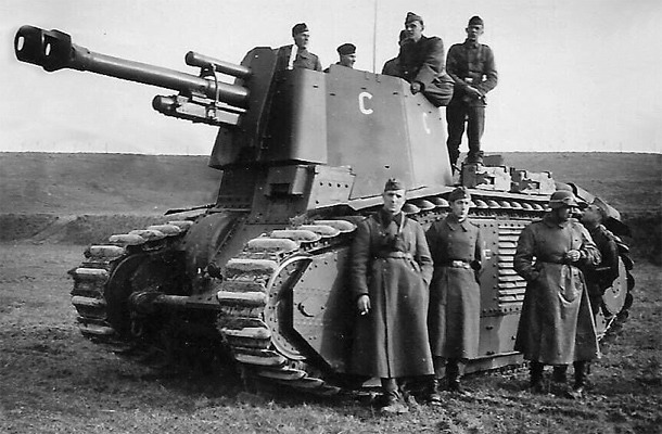

Finally, it is worth noting that individual self-propelled guns were rather unusually identified by large letters from A to P painted on the sides of their fighting compartments.
