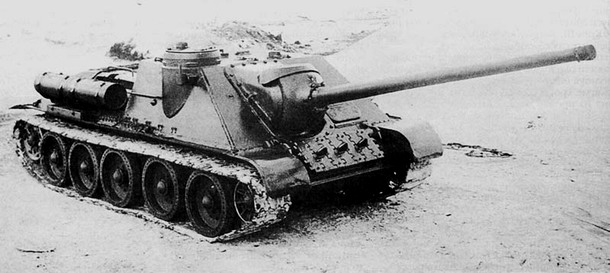

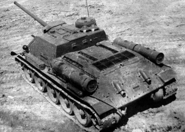

The SU-100 was derived from the earlier SU-85 and was also very similar to it at first glance. The vehicle was again built on the T-34 tank chassis, from which it also took the engine, gearbox and other components. The running gear comprised on each side the traditional five large rubber-rimmed road wheels, with a smaller drive sprocket at the rear and the smallest idler wheel at the front. The entire rear section with its engine compartment corresponded to the T-34. The forward half of the hull was occupied by a fixed superstructure welded from flat armoured plates, with a sharply sloped front wall to improve ballistic protection. It is noted that the SU-100 shared 84% of its components with existing T-34, SU-85 and SU-122 vehicles — only 16% of the self-propelled gun's parts were newly developed.

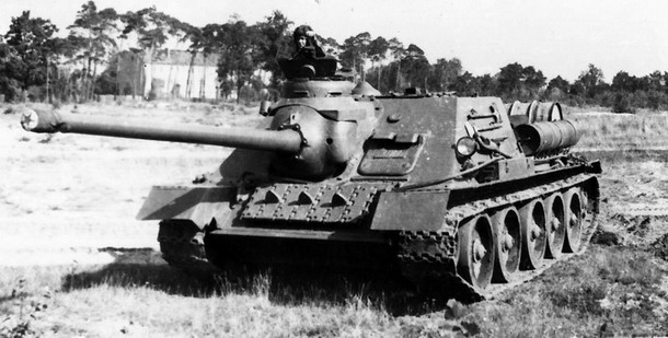

The most visible change from the earlier SU-85 was the commander's cupola, which appeared on the right side of the fighting compartment. The cupola body intruded noticeably into the right side wall. Around its circumference were narrow vision slots providing the commander with a full 360-degree field of view. In the cupola roof was a hatch for the commander's entry and exit, closed by a two-part cover, one section of which contained an observation periscope. Behind the cupola were two ventilation fans for the fighting compartment. A further entry/exit hatch with a two-part cover was in the front left section of the compartment roof, also fitted with an observation periscope in the cover. Finally, at the junction of the roof and the rear wall was the largest hatch of all, also used for loading ammunition and other supplies.
Another improvement over the SU-85 was the thicker front armour of the fighting compartment, which reached a full 75 mm (compared to 45 mm on the SU-85). The heavier armour and the larger gun naturally increased the weight at the front of the vehicle, putting greater stress on the front road wheels — which consequently required strengthened springs.
The main armament was of course also new: the already-mentioned 100 mm D-10S gun, with a barrel length of 53.5 calibres — that is, 535 cm. The gun was mounted in a massive 110 mm thick collar, with the sight aperture located to the left of the barrel within the collar. In armour penetration the D-10S outperformed both the German 75 mm KwK 42 (as fitted to the Panther) and the 88 mm KwK 36 (as fitted to the Tiger). It could not match the 88 mm KwK 43 of the Königstiger, however. Even against that weapon the Soviet gun held one advantage: thanks to its larger calibre, it could fire more powerful high-explosive fragmentation rounds than the Königstiger.

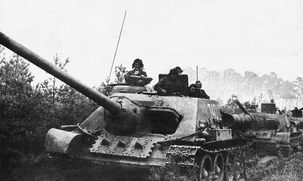

The SU-100's onboard ammunition stowage comprised 33 rounds in total: 18 armour-piercing BR-412B rounds (muzzle velocity 895 m/s) and 15 high-explosive OF-412 rounds. It is notable that almost half the ammunition carried was intended for use against enemy infantry, which suggests the SU-100 was viewed not as a pure tank destroyer but as a genuinely multi-purpose self-propelled gun. Information occasionally appears regarding the number of HEAT rounds carried, but as these were developed for the D-10S only after the war ended, this detail is most likely applicable only to the post-war period. In combat conditions the SU-100 could sustain a rate of fire of 5 to 6 rounds per minute.

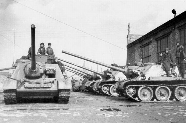

From December 1944 the completed SU-100s began to be organised into regiments and brigades. Each regiment consisted of four batteries of five vehicles plus one command vehicle. A self-propelled gun brigade comprised 65 vehicles in total. The SU-100 saw its combat debut in January 1945 and fought through to the very end of the war. Its most intensive employment was probably during the repulse of the German offensive codenamed Operation Frühlingserwachen at Lake Balaton in March 1945.
