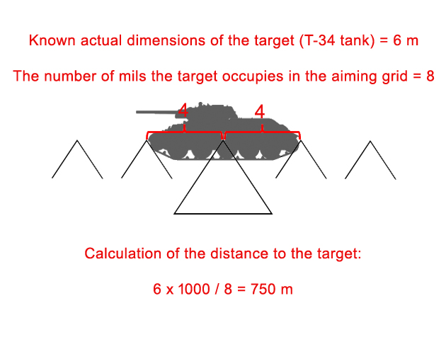

The fundamental method for determining target range was the so-called mil method. One artillery mil is an imaginary arc of a circle subtending 0.05625°. This arc has the unique property that at a distance of 1,000 metres from the apex it is exactly 1 metre wide. If such a mil is marked in some way in the sight, the gunner can compare it with the size of the observed target, and if he knows the target's dimensions he can calculate its range.
The reticle of the TZF 9b sight of the Tiger heavy tank, with the range indicator set to zero, source: Flickr.com with permission of the publishing user, edited

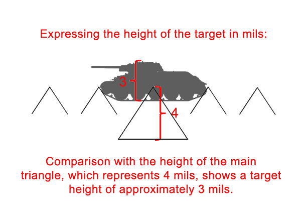

German tank sights had a reticle consisting of seven triangles placed side by side. The distance between the upper vertices of two adjacent triangles corresponded to 4 mils. This means that if the gunner was looking at a target 1,000 metres away and 4 metres wide, the target would fill exactly the space between the apices of two adjacent triangles. Every tank gunner had to know by heart the dimensions of the main types of enemy tanks, and when he spotted them in his sight he could compare them relatively easily against the reticle and calculate or at least estimate the target's range.

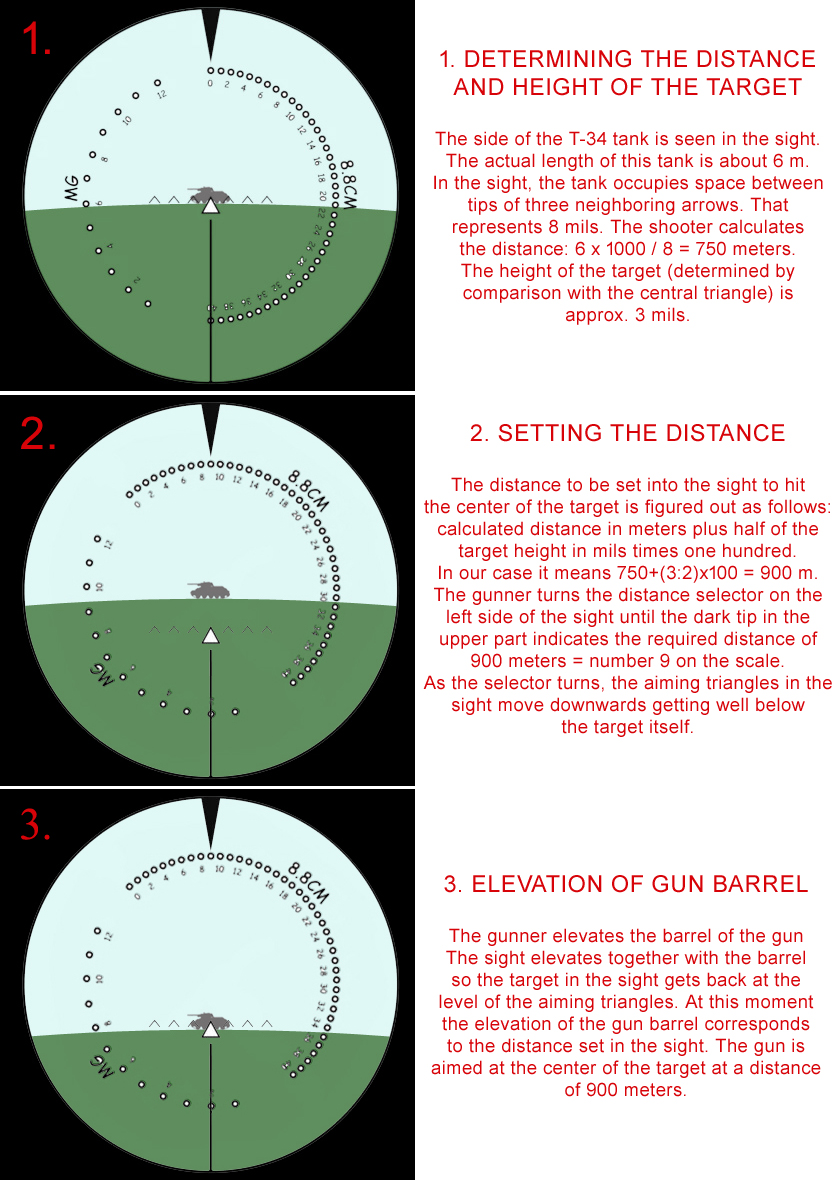

The formula for calculating range was: target width in metres multiplied by 1,000, divided by the number of mils the target occupied in the sight. So for example, if the gunner spotted the side silhouette of a T-34, which he knew was approximately 6 metres long, and this silhouette occupied 8 mils in the sight (i.e. two gaps between triangle apices), he calculated: 6 × 1,000 / 8 = 750 metres. For a clearer understanding, you may prefer to look at the diagram HERE. However, the raw range figure alone was not sufficient to correctly set the sight. If the gunner simply set the sight to 750 metres, the shell would land at the base of the target. To hit the target in its centre, he also had to account for its height. A simple procedure existed for this. The gunner had to estimate the target's height in mils (by comparing it with the central aiming triangle, whose height was 4 mils). Let us say he estimated the target's height at approximately 3 mils (as in the diagram HERE). He then simply took half of this estimated height (i.e. 1.5), multiplied it by 100 metres (1.5 × 100 m = 150 m) and added this value to the previously determined target range — and voilà, we have the number to set in the sight: 750 + 150 = 900 metres. If this all sounds complicated, bear in mind that in actual combat the gunner of course did not carry out such precise calculations. He relied primarily on experience and trained estimation. Moreover, hitting a target did not require everything to be calculated to the nearest metre or even to the nearest ten metres. The margin was in the hundreds of metres, as explained for example in the Tiger crew manual HERE.

The gunner then turns the wheel to increase the set range from zero up to 900 metres. Turning the wheel sets both glass plates in the sight in motion. The circular plate with the scale around its rim begins to rotate about its axis. The gunner continues until the indicator at the top of the field of view shows the required value of 900 metres. Turning the wheel, however, also moves the second glass plate — the one carrying the reticle. As the range is increased, this plate slides downward, so the seven triangles forming the reticle appear to drift down and away from the observed target. Once the gunner has set 900 metres, he sees the apex of the central triangle deep below the target. What does he do? Correct — he must begin elevating the gun barrel upward to bring the triangle back onto the target. The sight is coupled to the gun, so the angle of barrel elevation corresponds precisely to the ballistic curve for firing at the set range of 900 metres. Perhaps the simplest way to understand the full procedure is to look at the diagrams HERE.
Some readers may notice that after elevating the gun the gunner no longer sees the target in the centre of his field of view but somewhere in its lower portion. That is exactly right. Recall that the shorter front tube of the sight is connected through the gun mantlet to the barrel, so if the barrel is pointing above the target, the sight's lens is also pointing above the target. But could it happen that the gunner elevates the gun so high that the target disappears off the bottom of the field of view and cannot be seen at all? Theoretically yes — but in practice no. The sight's field of view generally corresponded to the range of the gun's vertical movement (the elevation arc). For example, the Panther's TZF 12 sight had a field of view of 28°, and the Panther's gun elevation range was -8° to +20°, a total of 28°. The Tiger II's TZF 9b/1 sight had a field of view of 25°, while the Tiger II's gun elevation range was -8° to +15°, a total of 23°. In short, even at maximum positive elevation the target (and the reticle image) could not escape beyond the sight's field of view.
