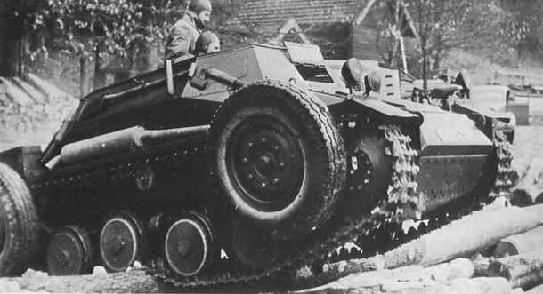

first prototype of the RK-9 without roof or turret during driving trials, source: Flickr.com with permission of the publishing user, edited
Contract for Saurer
Following the annexation in March 1938, the German army placed an order with the Austrian firm Saurer for the development and production of the half-track reconnaissance vehicle Sd.Kfz. 254. In mid-1938, a further order followed — this time for the development of a next-generation version of the vehicle, one that would carry its own integral armament. The designers decided against the simple approach of modifying the armoured superstructure to accommodate weapons, and instead embarked on a complete redesign, including the complex running gear system.
Perhaps for this very reason, work on the new armoured vehicle crawled along at a snail's pace. The first two prototypes were not completed until June 1942 — a full four years after the original commission. The project, which received the factory designation RK-9, was evidently no great priority for the army. The first prototype was incomplete, lacking both the roof of the fighting compartment and the turret to carry the armament. Even so, it was sufficient as a verification vehicle for conducting driving trials.

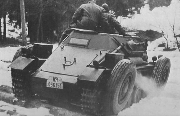

Like its predecessor the RK-7 — or the Sd.Kfz. 254, as it is better known — the new RK-9 was built around two interchangeable running systems. For road travel, the vehicle rode on four conventional wheels fitted with rubber tyres. For cross-country movement, it was equipped with a full tracked system. When switching from road to rough terrain, the wheels were raised and left hanging at the sides of the hull. The rear road wheels were driven, while the front ones were steerable. The track unit on each side consisted of four road wheels of relatively small diameter. These were solid wheels, fitted with rubber rims to absorb vibration. In their design they closely resembled the road wheels of the Panzer II tank. The drive sprocket was positioned at the front and the idler wheel at the rear of the track section. Three return rollers supported the upper run of the track.
A sheet-metal mudguard ran the full length of the track, and along the right-hand side of the vehicle the exhaust pipe was routed on top of it. The hull was welded from flat plates which, particularly at the front and rear, were steeply angled — a feature that improved their resistance to enemy fire. Armour thickness was 14.5 mm on the front face and 5.5 mm on the remaining surfaces. The extent of the armour protection was limited by the load-bearing capacity of the running gear, particularly the wheeled section, meaning the plating offered at best protection against small-arms fire and light shell fragments.

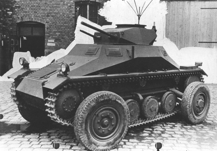

second prototype of the RK-9, complete with turret and armament, shown here in a retouched factory photograph, source: Flickr.com with permission of the publishing user, edited
The vehicle's combat weight was most likely in the region of 8.5 tonnes. On roads — that is, running on wheels — the RK-9 could reach a top speed of 80 km/h. On tracks across country, a respectable 30 km/h was achievable. Road range stood at approximately 250 km.
