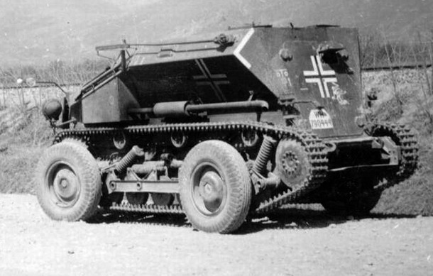

Sd.Kfz. 254, here running on wheels. Source: Flickr.com, used with permission of the publishing user, edited

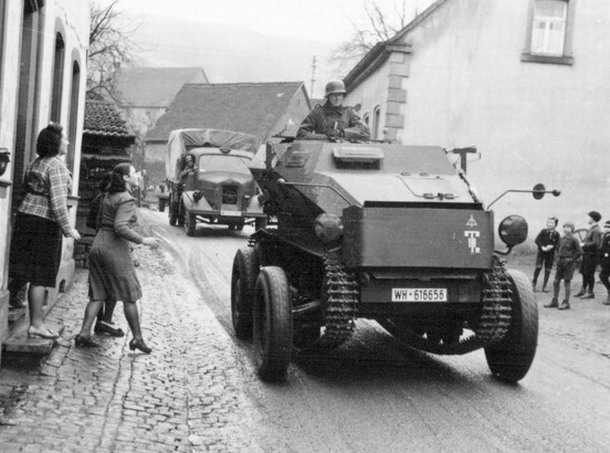

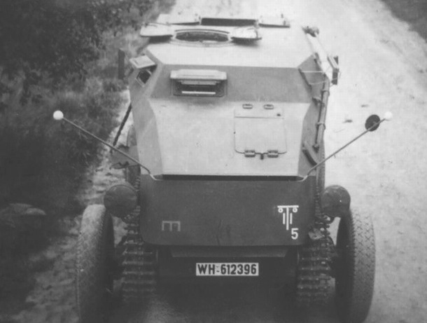

Rear view of the Sd.Kfz. 254 — the ghost image indicates belonging to the 11th Panzer Division. Source: Flickr.com, used with permission of the publishing user, edited
By the time of the Anschluss of Austria in March 1938, only 15 RR-7 vehicles had been completed (other figures are sometimes cited). Production was then halted amid uncertainty over whether the army would still want the tractor. The German Army Weapons Office eventually decided to resume production — but no longer in the original form or for the original purpose. Instead, an armoured variant was ordered, intended for reconnaissance and artillery observation duties. The armoured vehicle received the new designation RR-7/2 and the standard German army code Sd.Kfz. 254. Its official German name was Mittlere Gepanzerte Beobachtungskraftwagen SdKfz 254 — literally "medium armoured observation vehicle".

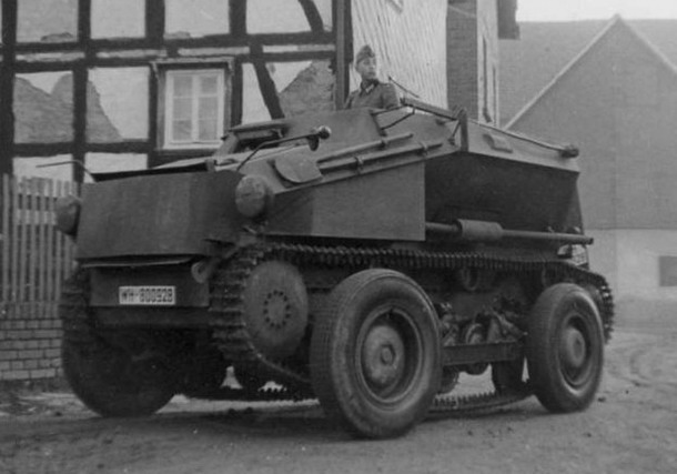

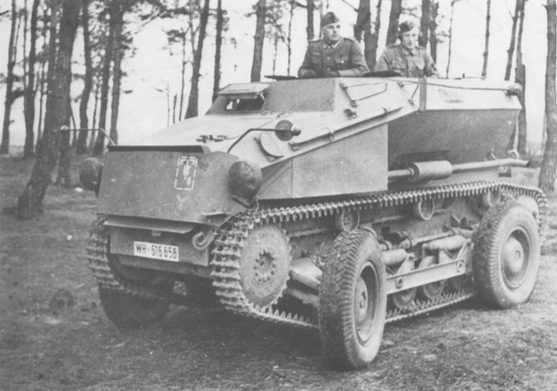

The tracked portion of the Sd.Kfz. 254's running gear consisted of six fairly small road wheels on each side. The first and last of these were each independently sprung by a diagonally-mounted coil spring. The remaining four road wheels were paired and shared a single horizontal coil spring. The entire spring system was mounted externally on the hull sides. The first five wheels were spaced at regular close intervals, while the sixth was set further back, separated from the others by the mounting of the rear road wheel. The track assembly was completed by a front drive sprocket and a rear idler wheel, both of the same design, with the upper run of the track supported by three return rollers.
The wheeled portion of the running gear consisted of four conventional pneumatic-tyred wheels. The front wheel was mounted between the drive sprocket and the first track road wheel. The rear wheel was positioned between the already-mentioned fifth and sixth track road wheels. When running on tracks, the road wheels were raised up alongside the hull, clear of the ground. On road, the wheels were lowered until the entire vehicle was lifted on them and the tracks rose above the road surface, allowing the vehicle to proceed. The mechanism for raising and lowering the wheels was driven by the vehicle's engine.

The powerplant was the water-cooled four-cylinder Saurer CRDv diesel, displacing 5.5 litres and producing a maximum of 70 horsepower at 2,000 rpm. The gearbox offered five forward gears and one reverse. On wheels the vehicle could reach up to 60 km/h and cover approximately 500 km on a full tank of 72 litres of diesel. Maximum speed on tracks was around 30 km/h. The Sd.Kfz. 254 weighed 6.4 tonnes.
The armoured hull was vaguely reminiscent of the half-track personnel carrier Sd.Kfz. 251 in its overall form — a traditional German design with the lower and upper sections of the side walls angled in opposite directions, so that the hull widened upward from the floor, then the side wall broke angle and the hull narrowed again toward the roof. At the front was the engine compartment with a flat front plate and a fairly tall bonnet. The front plate was not rigidly connected to the rest of the hull but effectively suspended from it, with a gap between it and the adjoining walls to allow airflow to the engine. The entire front plate could most likely be removed to gain access to the powerplant. A further service opening for engine access was located in the left section of the bonnet's upper plate.
The crew compartment began behind the engine section. In the right section of its front wall was the driver's vision port — traditionally designed as a closable port with a cover fitted with an observation slit, which the driver used in combat areas where opening the full port might be dangerous. A further vision port for the driver was provided in the side wall to his right. The driver entered and exited through a hatch in the lower portion of the right side wall. This hatch had a single-piece cover that opened somewhat unusually downward. Because of the tracks, the cover could not be opened completely flat, and given this and its dimensions, squeezing through it was probably not particularly comfortable.

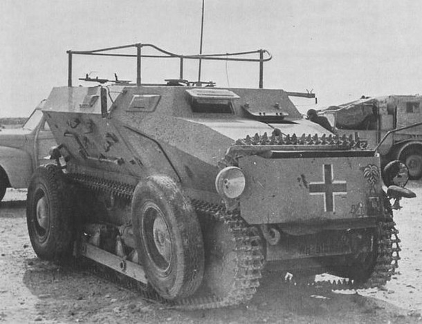

Given its mission, the ability to communicate with other units — and particularly with the artillery it served as the eyes for — was crucial for the Sd.Kfz. 254. The radio on board was most likely a FuG 8 set with a range of up to 50 km using Morse code. A rod aerial at the left rear of the hull served this radio; it could be folded forward, with its end resting in a metal channel that protected it. Some vehicles were probably equipped with additional radio sets and received a second aerial — this time a frame aerial, which ran around the roof of the hull on four supports.
Sd.Kfz. 254 with the unusual frame aerial, captured by the Allies in Africa. Source: Wikimedia, Public domain, edited

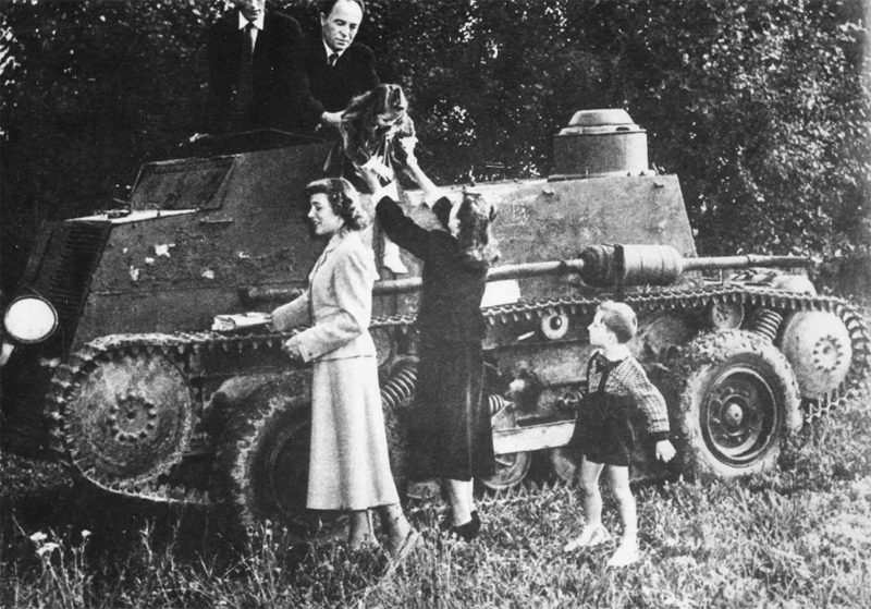

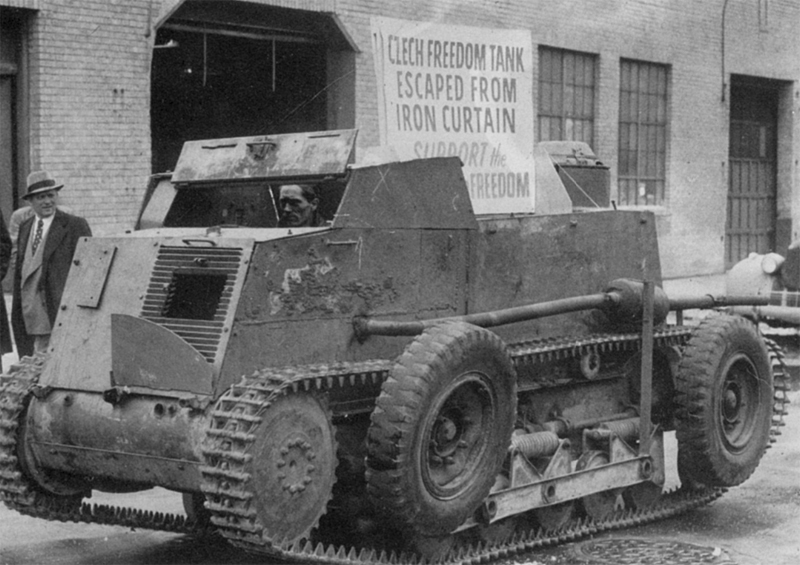

Long after the war ended, one example of the Sd.Kfz. 254 — or at least part of one — found a most remarkable new purpose. A man named Uhlík, a native of the Šumava region of Bohemia, acquired the running gear from a wreck that had apparently remained somewhere on Czech territory and built a new metal cabin of his own design on top of it. On 25 July 1953 he loaded his two children, his wife, and four other adults into this contraption and drove it through a barbed wire barrier across the border of the Czechoslovak Socialist Republic into Germany. His creation attracted well-deserved interest from journalists, and was apparently later transported to the United States and displayed in some museum. Photographs of this curious conversion can be found HERE and HERE.
