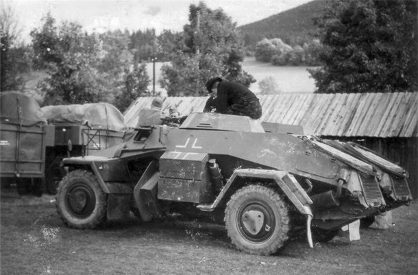

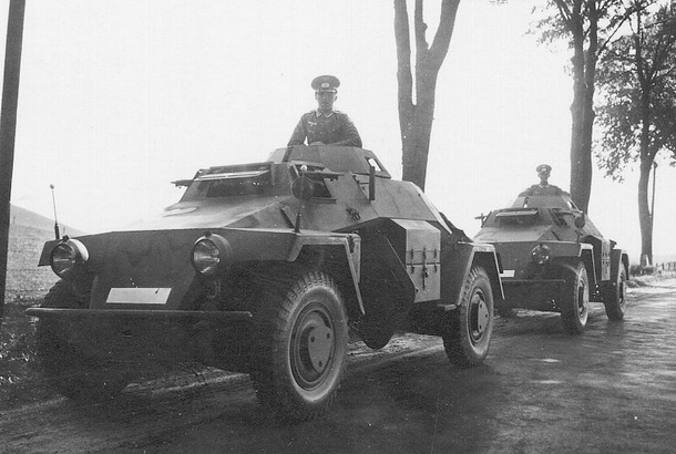

Sd.Kfz. 221 armoured cars — note the open access hatch in the side wall. Source: uludagsozluk.com, edited

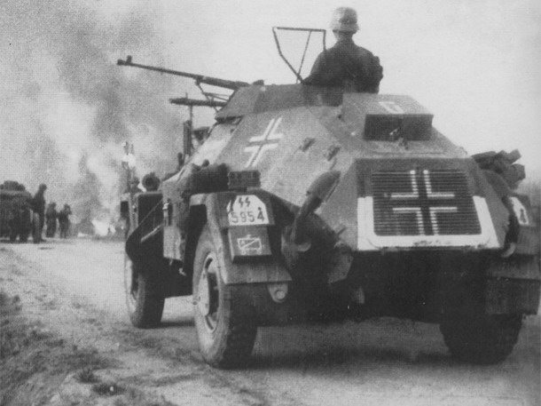

Rear view of the Sd.Kfz. 221, source: warwheels.net, used with permission of the site operator, edited

The driver sat in the nose of the vehicle, slightly to the left of the centreline, and steered using a conventional car steering wheel. To enter and exit, he could use either of the access hatches cut into both side walls beside his position, located in the lower portion of the sides. The hatches were shaped as irregular trapezoids, and their single-piece cover opened toward the rear of the vehicle. The roof above the driver's head was slightly raised compared to the rest of the roof.

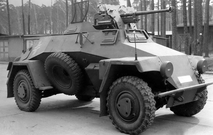

As already noted, the Sd.Kfz. 221's sole armament was the 7.92 mm MG34 machine gun, for which 1,050 to 1,200 rounds of ammunition were carried. The gun's vertical elevation ranged from -10° to +69°, which meant it could be used against low-flying aircraft. For this purpose it was sometimes fitted with an additional aircraft sight — the so-called Fliegervisier — alongside the standard sights. The crew also carried a submachine gun, either the MP38 or MP40, as supplementary personal armament inside the vehicle.

Virtually the entire rear wall of the hull was taken up by the engine access cover, which was louvred to allow airflow to the engine and shaped as a trapezoid with only a very gentle taper toward the top — almost rectangular. Access to the engine was also possible through a large service hatch in the top of the bonnet and two smaller ones in its side walls. One exhaust pipe emerged on each side from the engine compartment, disappearing behind the rear mudguard and running beneath the hull.

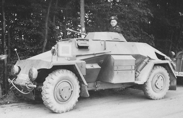

The space on the hull sides between the front and rear mudguards was used for stowing various equipment. On the left side of the vehicle, behind the driver's hatch, a large tool box was mounted. The spare wheel hung on the right side. Some vehicles were quite literally festooned with additional stowage boxes, a jack, a fire extinguisher, jerry cans for fuel and water, and similar items.

The MG34 machine gun alone was obviously not a very effective weapon, particularly when facing enemy armoured vehicles. Accordingly, in approximately 1941 a number of Sd.Kfz. 221 examples were retrofitted with a Panzerbüchse 39 anti-tank rifle in 7.92 mm calibre alongside the machine gun. The rifle was mounted independently of the machine gun so that each weapon could be elevated separately. A new aperture was cut in the turret armour for the rifle barrel, to the right of the machine gun.
