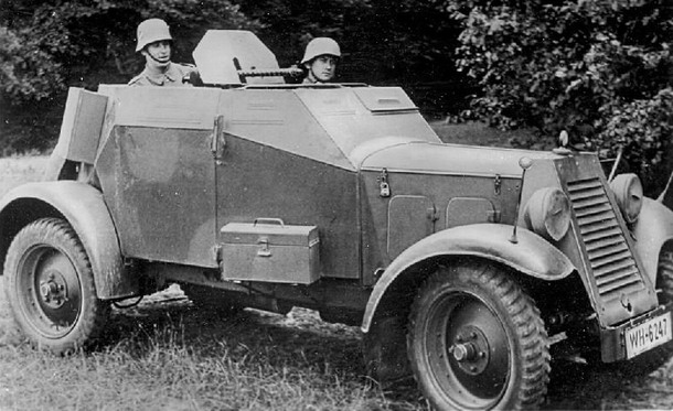

Armoured car Kfz 13. Source: Flickr.com, used with permission of the publishing user, edited

A new armoured crew compartment was fitted to the automotive chassis. The engine bonnet appears to have been taken directly from the civilian passenger car without modification — only a new armoured front grille was added. It was only on later vehicles that certain changes to the engine bonnet were made: photographs show that at minimum the original louvred side panels were replaced by solid openable plates. The new front grille itself was angular, with metal louvres covering most of its area to allow airflow to the engine. At its lower section was a circular closable opening for inserting the starting crank.

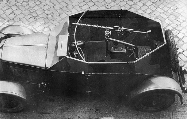

Fine view into the interior of the Kfz 13. Source: Flickr.com, used with permission of the publishing user, edited

The armoured compartments were supplied by Deutsche Edelstahlwerke of Hannover. Their solution was extremely simple: flat welded steel plates, 8 mm thick. The compartment had a hexagonal plan, with its walls first flaring outward from the engine section, then reaching their widest point, before narrowing again toward the rear. In the left section of the front wall was an elongated driver's vision port, which was closed by a cover fitted with an observation slit when moving in a dangerous area. A further large vision port was provided in the rear wall. Thanks to the angled front grille and front wall, the vehicle could resist 7.92 mm armour-piercing ammunition from the front. From the sides and rear, the armour was only sufficient to stop standard rifle-calibre rounds.
The roof of the compartment was left completely open. The overall shape of the compartment is said to have earned the vehicle the nickname "Badewanne" — bathtub — among its crews.
Inside the compartment were positions for the vehicle's only two crew members. The driver, who also served as commander, sat at the front left and operated the vehicle with a conventional steering wheel. In the rear section of the compartment, a rotating pedestal for a 7.92 mm MG13 machine gun was bolted to the floor, allowing full 360° traverse. Maximum positive elevation was 65°. The great majority of vehicles had a small simple gun shield fitted to the machine gun, providing some protection for the gunner. On some vehicles the MG13 was later replaced by the more modern MG34 of the same calibre. The vehicle carried 1,000 rounds of ammunition. The floor of the compartment was made from chequerplate to prevent the gunner from slipping while operating the weapon.

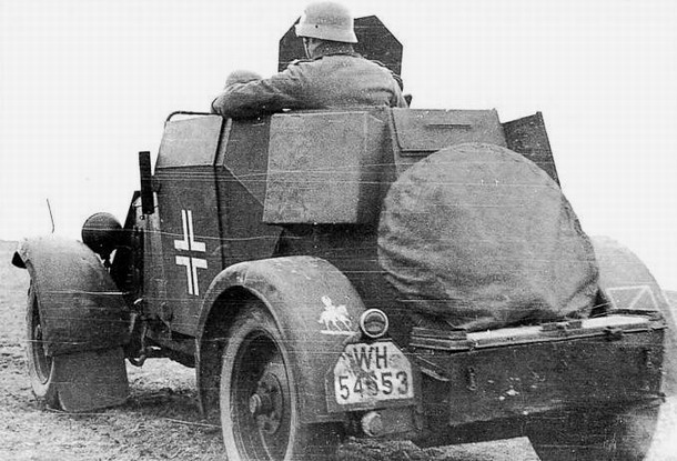

Both crew members entered and exited through large doors in the sides of the compartment. These covered practically the entire widest section of the side walls and opened toward the front of the vehicle, just like a conventional car door. At the rear, stowage boxes were mounted on the tapering sections of the side walls. The flat rear wall was almost entirely occupied by the stowed spare wheel. Below the spare wheel, in place of a rear bumper, sat another large box — presumably for tools.

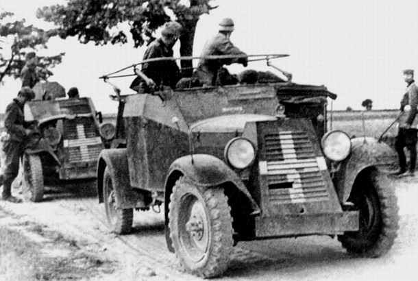

Armoured radio car Kfz 14. Source: Flickr.com, used with permission of the publishing user, edited
What is, however, entirely clear from photographs is that two different wheel designs were used during the production run. On the first series vehicles the wheels were taken directly from the Adler Standard 6 civilian car along with the chassis, and had flat pressed steel discs. They were later replaced by wheels from the Adler 12 N-3G cross-country vehicle, produced from 1933, which had discs with a domed centre hub.

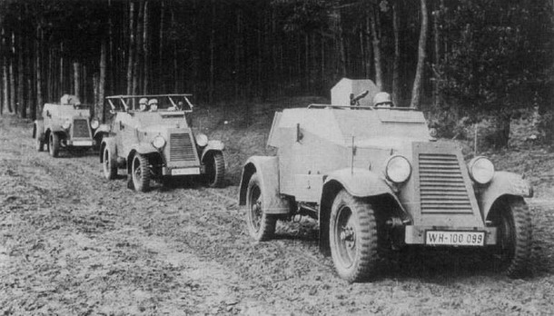

Alongside the standard Kfz 13, a modified version was produced simultaneously under the name Funkkraftwagen with the designation Kfz 14. As the name implies, this was an armoured radio car. A total of 40 examples of this variant were built.
The Kfz 14 was unarmed, as the machine gun mount had to give way to the Fu 9 radio set (and presumably also to a third crew member). Alongside the radio, a large frame aerial was installed, mounted on four supports above the fighting compartment. The supports were hinged, allowing the aerial to be folded down. Some sources state that the crew of the Kfz 14 grew to three — driver, commander, and radio operator. In the absence of a machine gun, the crew's only weapons were their personal sidearms.
Two Kfz 13 vehicles and a Kfz 14. Source: Flickr.com, used with permission of the publishing user, edited
