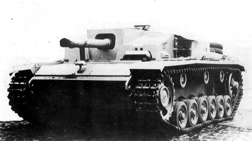

StuG (Flamm) in an excellent factory photograph; this vehicle clearly uses a hull from the StuG III Ausf. F/8; source: Flickr.com, edited

The first nine completed StuG (Flamm) vehicles were accepted by the army in May 1943, with the tenth and final one following a month later. All ten were subsequently handed over to the Panzertruppenschule I training centre in Munster for testing. The technical details of their construction are unfortunately not known. We do know that each vehicle had a three-man crew consisting of a driver, a radio operator, and a commander who also operated the flamethrower. The flamethrower nozzle was concealed inside a tube that was presumably intended to imitate the barrel of a standard gun. The front plate of the fighting compartment had evidently been modified to some extent. No dedicated aiming periscope is visible in any of the photographs; it is possible that one was housed somewhere within the aperture in the front plate directly above the flamethrower barrel.
Very few photographs of the flame StuGs have survived. Apart from the reasonably good factory image, there is a series of snapshots from a military equipment display, in which one StuG (Flamm) can be spotted among other vehicles. While the flame Sturmgeschütz in the factory photograph is clearly built on an Ausf. F/8 hull, the one from the display appears to have an older Ausf. F hull – the two can be distinguished by the design of the towing cable eyes on the front hull plate. This confirms that the vehicles were built on a variety of older hulls sourced from assault guns undergoing repair.
