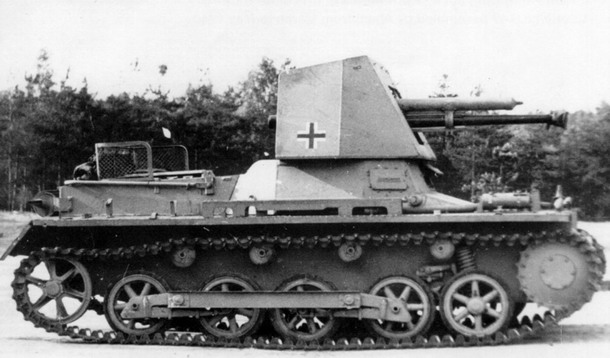

Panzerjäger I from the first production series. Source: Flickr.com, with the permission of the publishing user, edited.

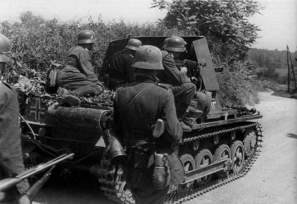

Panzerjäger I from the first production series. The rear of the vehicle shows the storage rack and the folded-down tarpaulin support frame. Source: Flickr.com, with the permission of the publishing user, edited.

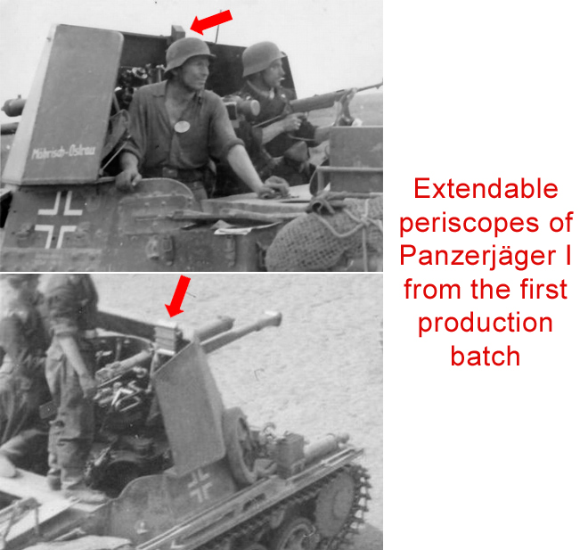

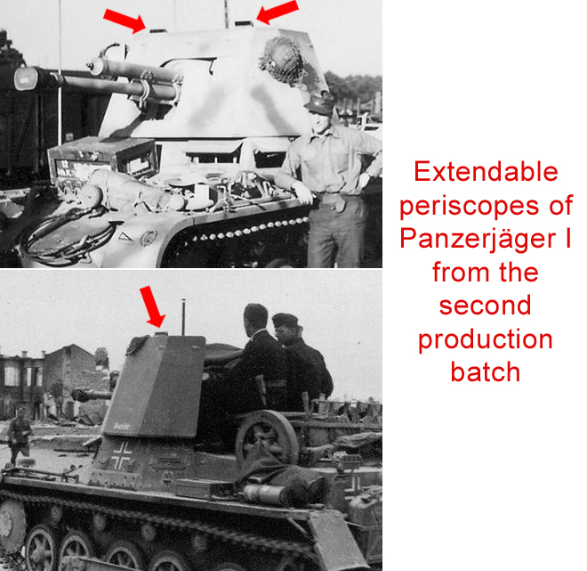

The armoured superstructure protected the gun compartment from the front and sides only. The thickness of its walls was sufficient to stop armour-piercing rifle-calibre bullets (7.92 mm) and small shell splinters. The gun crew originally had no observation periscopes and had to look out from the fighting compartment simply by peering over the top of the armour – which was not exactly safe. In the combat zone, the crew therefore kept their steel helmets on at all times, as is clearly visible in a large number of photographs. However, other photographs show observation periscopes extending above the front armour of the fighting compartment. It appears that some vehicles had these retrofitted in response to crew complaints – most likely by field workshops acting on their own initiative (photo HERE).

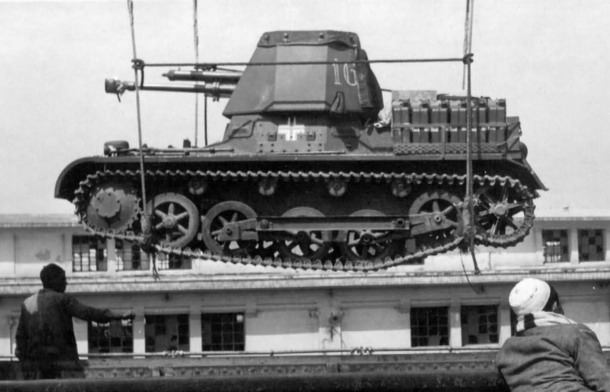

Panzerjäger I from the second production series being unloaded from a ship in the port of Tunis. Source: worldwarphotos.info, with the permission of the site operator, edited.

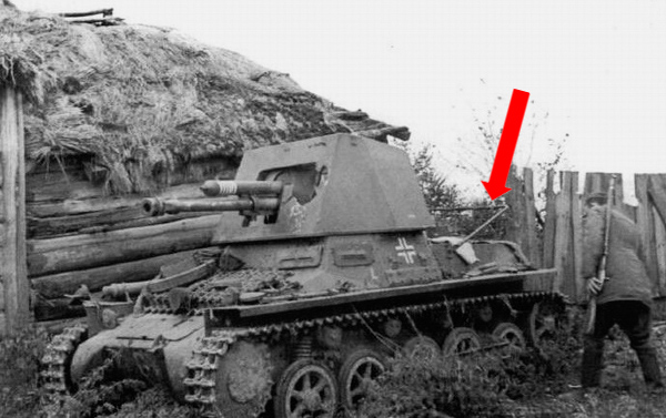

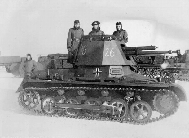

Since the armoured superstructure around the fighting compartment was left open at the top and rear, the vehicle's equipment included a waterproof tarpaulin that could be used to cover the open roof. The tarpaulin was secured by leather straps to small hooks welded just below the upper edge of the fighting compartment armour. At the rear it was suspended from a tubular frame which first had to be erected – in normal use this frame lay folded flat along the engine deck. The folded frame can be seen in photographs HERE, HERE and HERE; I have not come across a single photograph showing the frame fully erected – rigging the tarpaulin over it was evidently not a task the crews looked forward to. Tarpaulin or not, rainwater could find its way into the open fighting compartment quite easily, so a closable drain hole was built into the left rear section of the floor to allow any water that did get in to drain away quickly.

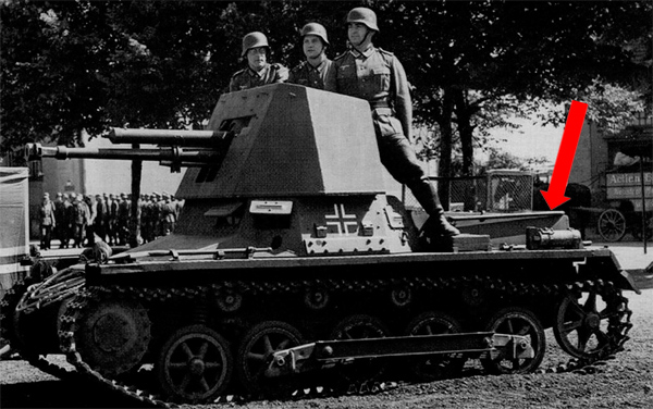

Panzerjäger I from the second production series in the Russian winter – note the tarpaulin fitted over the roof of the fighting compartment. Source: Flickr.com, with the permission of the publishing user, edited.

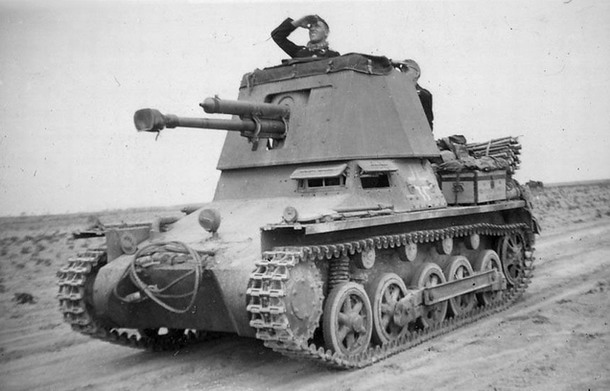

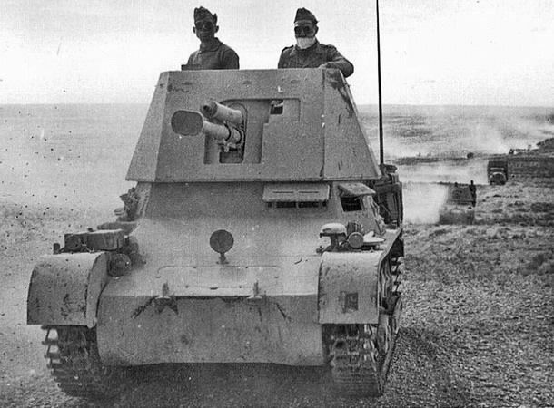

The tank destroyer's crew consisted of three men. The driver sat on the left inside the hull and was also responsible for operating the radio, which was housed in a metal box suspended to his right. The box was mounted on flexible brackets to isolate the sensitive radio equipment from the vehicle's vibrations. Panzerjäger Is from the first production series were fitted with a Fu 2 radio receiver – receive-only. A 140 cm rod antenna was attached to a folding bracket on the right side of the hull. The other two crew members had their seats at the rear wall of the fighting compartment: the loader on the right and the commander, who also served as gunner, on the left.
Panzerjäger I from Pz.Jg.Abt 605 in the African sand – a second production series vehicle. Note the antenna on the left side and the jerricans of drinking water stored on the rear mudguard. Source: Flickr.com, with the permission of the publishing user, edited.

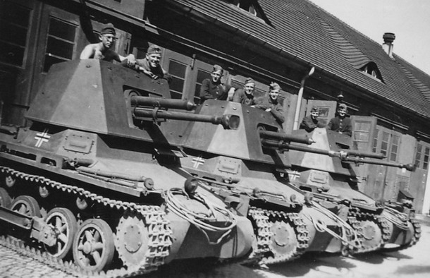

Perhaps because the Panzerjäger I was at the time the only weapon of its kind and available only in limited numbers, these vehicles were not distributed among the Panzer divisions but instead concentrated in Army-level anti-tank battalions (subordinate to Army command rather than divisional command). In March 1940 the formation of a training company for self-propelled tank destroyers was ordered – the Pz.Jg.Ersatzkp. (Sfl.) (in full: Panzerjäger Ersatzkompanie (Selbstfahrlafette)). This company was responsible for training crews for the combat units equipped with the new tank destroyers. In the same month, four existing anti-tank battalions were ordered to reequip from towed guns to Panzerjäger Is: the existing Panzerabwehr-Abteilung 521, 616, 643 and 670 were reorganised as Panzerjäger-Abteilung 521, 616, 643 and 670 (abbreviated Pz.Jg.Abt). The change of name was intended to signal the shift from merely defending against tanks to actively hunting them – whether that was more than a psychological word game is another question. A tank destroyer battalion (Panzerjäger-Abteilung) consisted of a headquarters, a signals platoon and three combat companies (Panzerjäger Kompanie, official abbreviation Pz.Jg.Kp (mot S), where (mot S) stood for motorisierte Selbstfahrlafette). Each combat company fielded 9 tank destroyers, giving the battalion a total of 27.

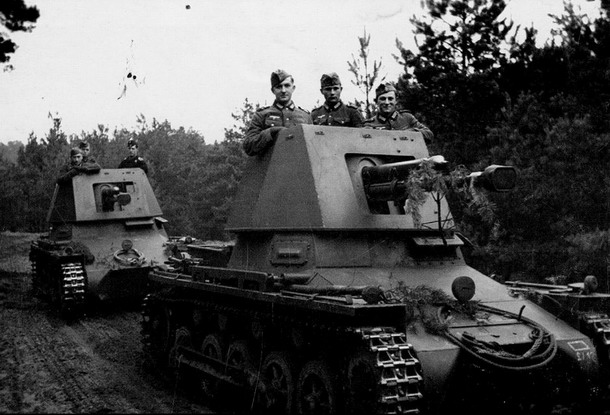

Two Panzerjäger Is from the mixed training unit Lehrbrigade 900 (mot). Source: Flickr.com, with the permission of the publishing user, edited.
