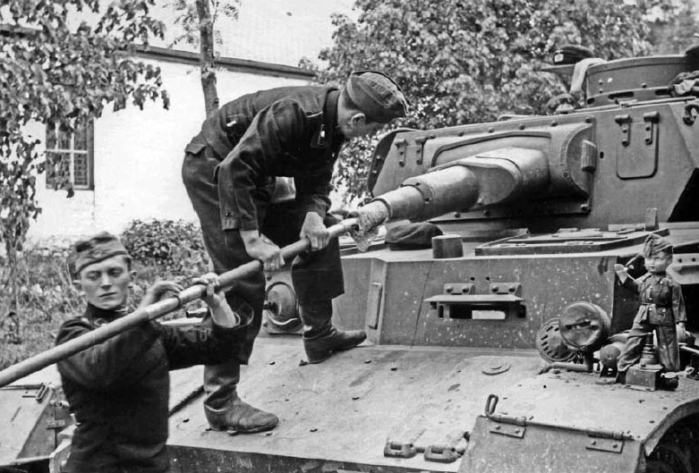

cleaning the 75 mm gun of a Panzer IV Ausf. A, source: Flickr.com, courtesy of the publishing user, edited

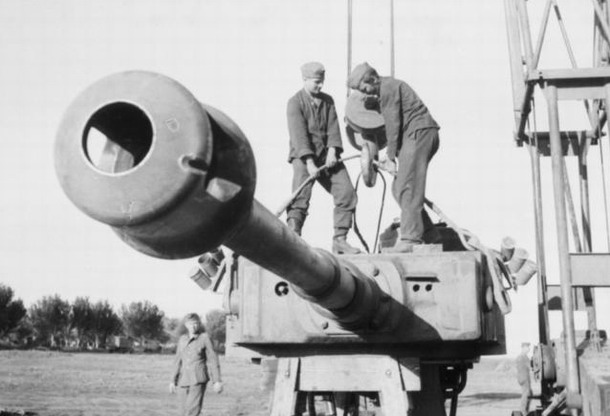

the barrel of a Tiger tank — note the damage to the muzzle brake, apparently caused by an enemy anti-tank rifle, source: Bundesarchiv_Bild_101I-022-2923-07A, Wikimedia, Creative commons, edited

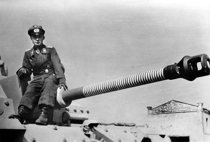

Lieutenant Walther Oberloskamp sitting on the 75 mm gun of his StuG III assault gun, with 40 kill rings painted on the barrel, source: Flickr.com, courtesy of the publishing user, edited

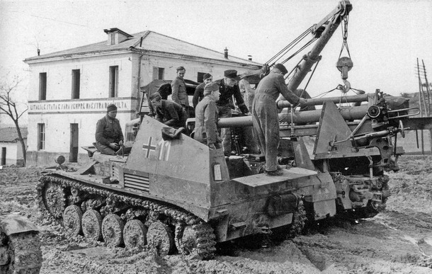

removing the 105 mm howitzer from a Wespe self-propelled gun, source: Flickr.com, courtesy of the publishing user, edited
