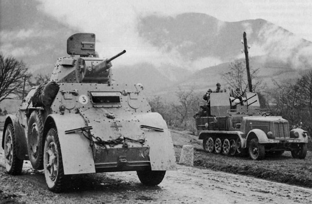

Panzerspähwagen AB41 201(i) and an Sd.Kfz. 7/1 fighting against partisans in the Yugoslav mountains; the vehicle has been fitted with extended front mudguards to protect the tyres from being shot out, source: flickr.com with the permission of the publishing user, edited

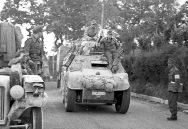

Panzerspähwagen AB41 201(i) passing an Sd.Kfz. 10/4 half-track, source: Bundesarchiv Bild 101I-315-1111-02, Wikimedia, Creative commons, edited

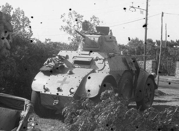

Panzerspähwagen AB41 201(i), apparently in Luftwaffe service, source: Bundesarchiv Bild 101I-304-0608-21A, Wikimedia, Creative commons, edited

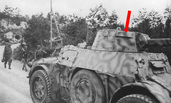

Virtually all sources agree that the fighting turret for the AB41 was taken from the light tank L6/40. However, they say almost nothing about the modifications the turret had to undergo in the process of being fitted to the armoured car. The most obvious new feature was ventilation louvres in the side walls, protected on the outside by riveted covers (photo HERE). There are, however, certain indications that other, less obvious but arguably more significant structural changes were also made. The first clue is the stated range of vertical weapon movement in the turret's front wall. While the L6/40 tank is typically credited with elevation limits of −12° to +20°, the AB41 is said to have had only −9° to +18°. Was this a consequence of structural modifications to the turret, or simply a minor error in the figures cited? Then there is another matter entirely. The fighting turret of the L6/40 tank had walls 30 mm thick at the front and 15 mm on the sides and rear. How, then, to explain the findings of a British report on the examination of a captured AB41, issued in May 1943 at Chobham, which states that the front wall of the fighting turret has armour 18 mm thick while the remaining turret walls are only 9 mm (figures that some publications also cite)? And photographs, too, reveal a visible difference in the thickness of the front wall between the L6/40's turret and that fitted to the AB41.

The armoured car's crew comprised four men: a front driver, a rear driver, a radio operator who was also responsible for the rear hull machine gun, and a commander, who operated both weapons in the rotating turret. On the subject of radio equipment, the standard fit was the Magneti Marelli RF 3M, a combined receiver-transmitter. Both units were housed on the left side wall of the fighting compartment and connected to a folding antenna on the left front corner of the hull. Command vehicles, however, carried the RF 2CA set, with its antenna positioned on the left rear corner of the hull instead.

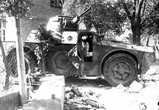

this abandoned wreck of a Panzerspähwagen AB41 201(i) was reportedly found in captured Berlin in May 1945, source: flickr.com with the permission of the publishing user, edited

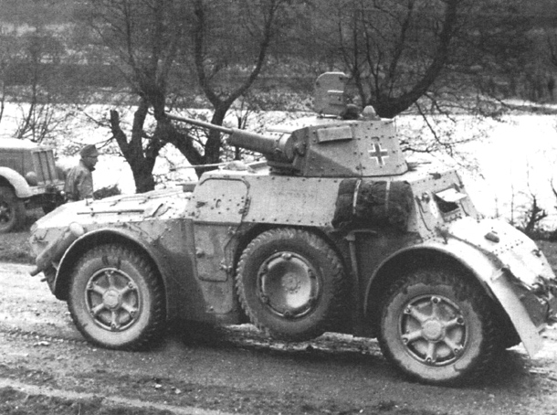

German crews modified their captured vehicles in various ways to suit their own preferences. Sometimes they limited themselves to applying a new camouflage scheme, but photographs also show vehicles fitted with additional appliqué armour on the front hull wall, or with extended front mudguards to protect the front wheel tyres from enemy fire.
